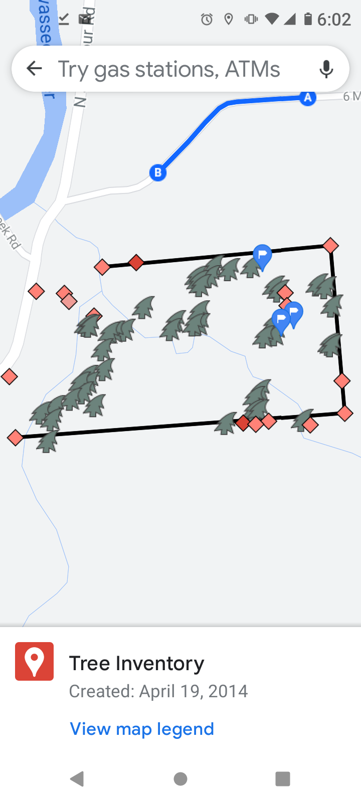

I have used the software for my Garmin GPS to find where I own, draw lines between the points. Should be quit accurate, you might be able to do this on a custom map on Google map and have it up on your phone. On my GPS it will be +/- between 0 and around 2 meters toleranse, I think that's the best I can hope for with affordable equipment, get the same on my phone.

Find corners and other witness points, add waypoints, draw lines. Took several reads over many months before finalizing map.
