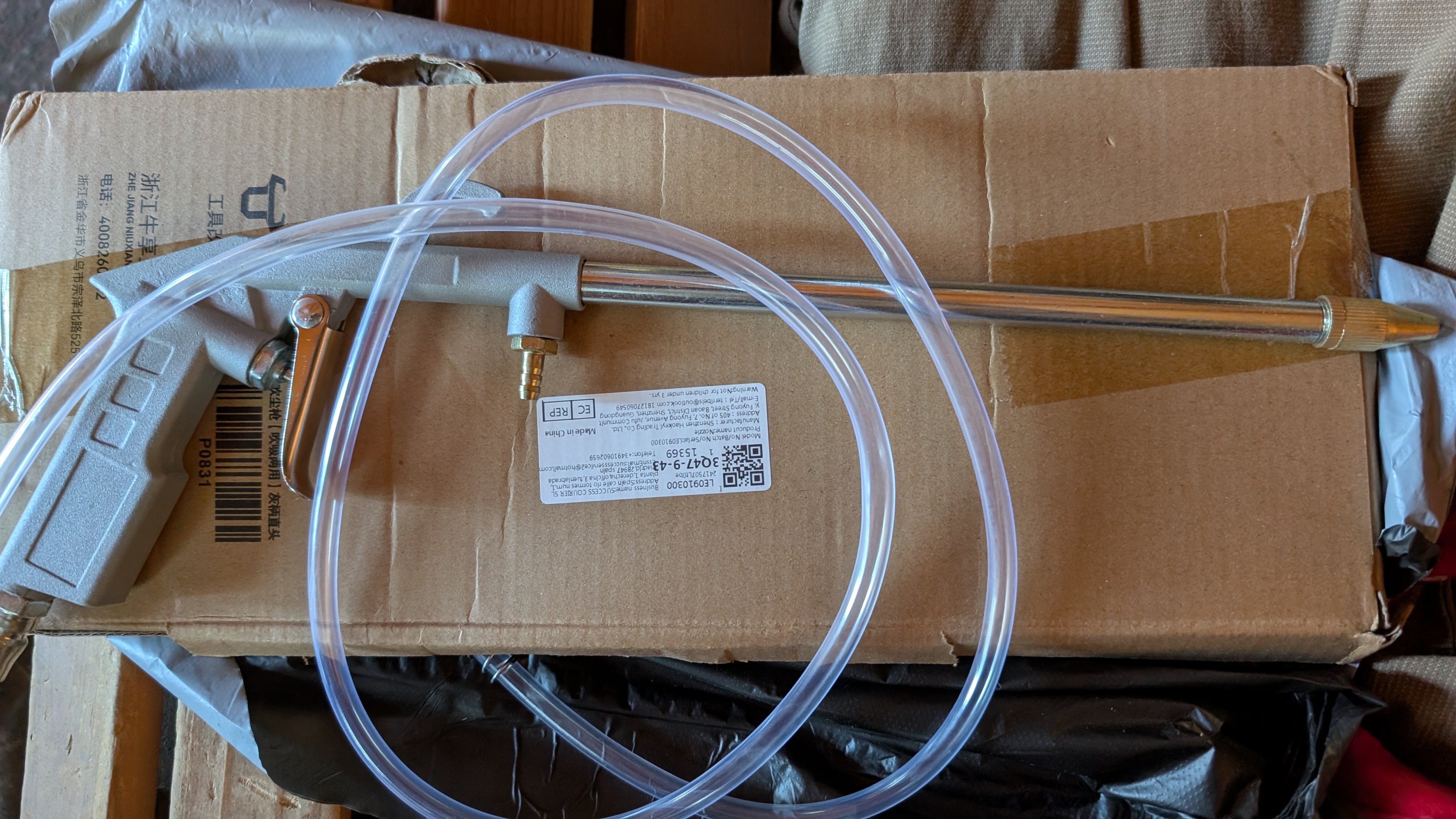

I finally found one of these for a solvent mist with compressed air:
