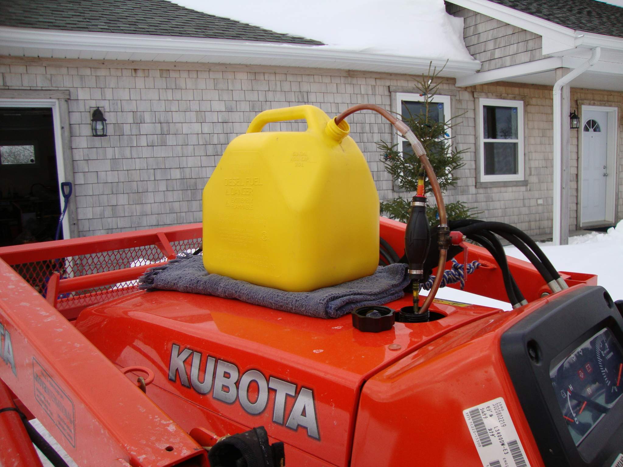

I use a home-made siphon setup with an outboard primer bulb to get it started. Sit the can on the hood on a blanket, squeeze the bulb a few times, open a valve and wait for it to empty the can. Takes about 3 minutes for 5 gallons.
Sean

Great idea.
