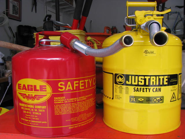

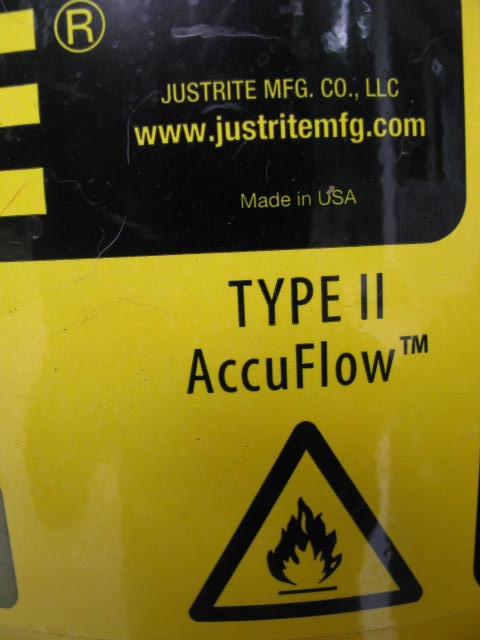

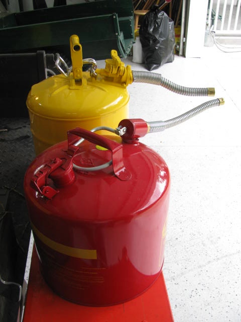

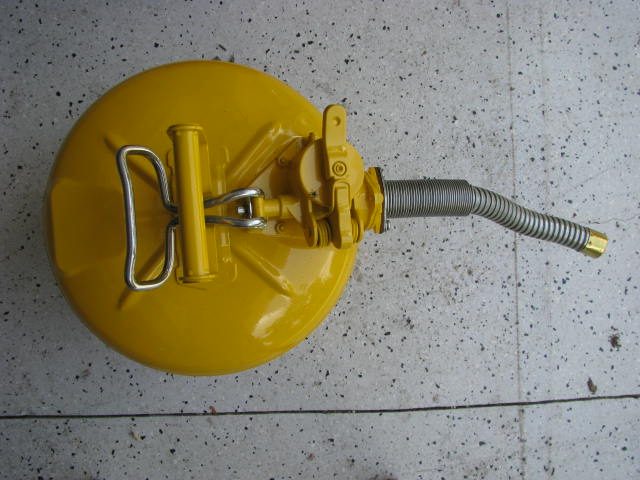

Attached are photos of EAGLE/Red and JUSTRITE/Yellow steel, made in the USA, Type II fuel cans. They are both lifetime cans. You will NOT spill or drip due to the design of the cans. I prefer the JUSTRITE can due of the larger diameter metal filler and because the JUSTRITE filler bale works a little better for me.
These are self-venting cans. As it heats up during the day here in Florida both cans occasionally hiss a split second. (Vent desired by thread originator.)
I bought my two cans together from Amazon.com Free shipping over $25 and NO sales tax. Still expensive fuel cans but worth it for the quality. Order carefully....specify the filler inner diameter you prefer for your tasks. Red, Yellow, Green, Blue and maybe Puce paint available.
If you want five gallon capacity cans these are of the HIGHEST QUALITY.
