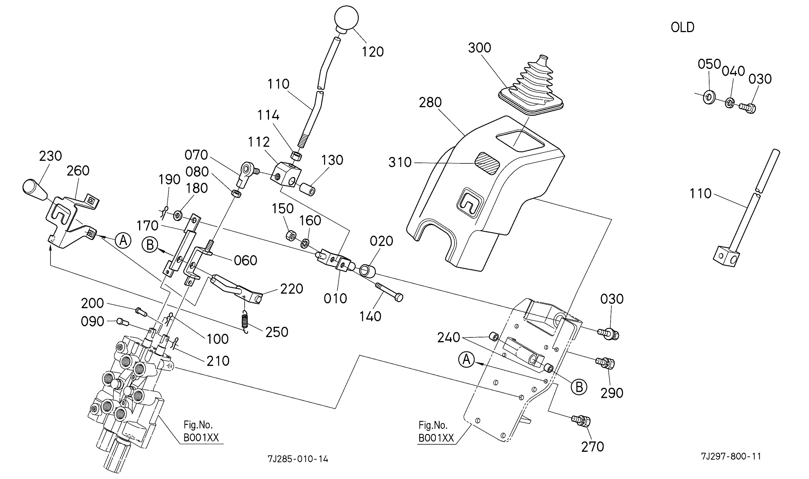

IF your tractor is a AGCO build/product....You start here...
   / How do you find the correct part numbers for tractors? #9
You can also look up parts on the Kubota USA website.
Many of the tractor manufacturers have parts lookup on their websites.
Yes, but it has no numbers, just a diagram, so very little to go on..
