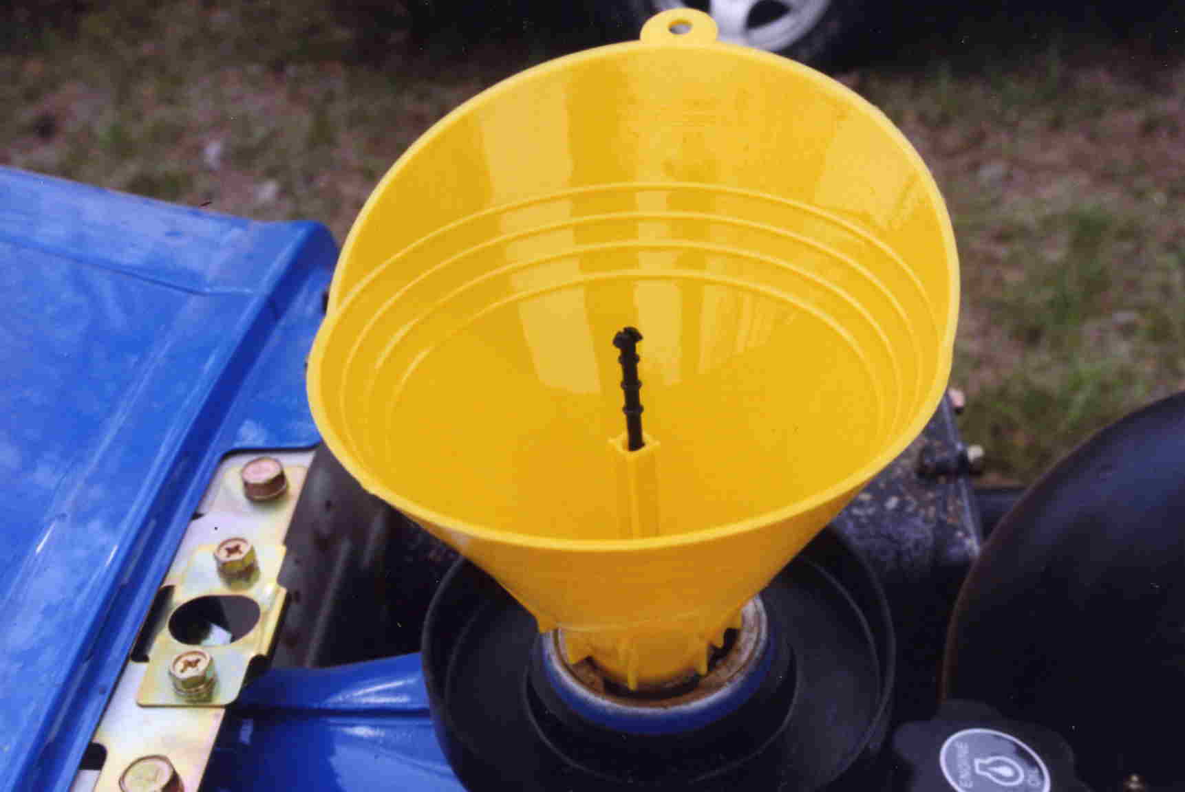

OK guys, I'm back. With pictures! Here is one of my 2 gallon can and funnel. No, I couldn't find a yellow, so the red had to do.

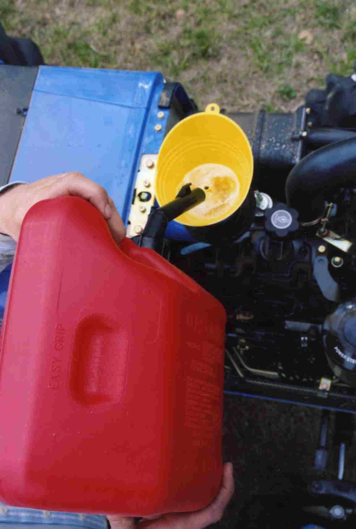

This one shows the flag being sent up by the foat when tank is full. It works well. I haven't spilled a drop yet.
