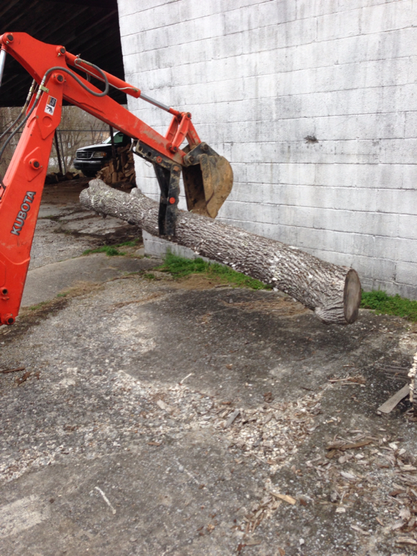

A thumb for the backhoe works pretty good for picking up things. A hydraulic thumb would be a lot better, but that adds a bunch of $$$.
