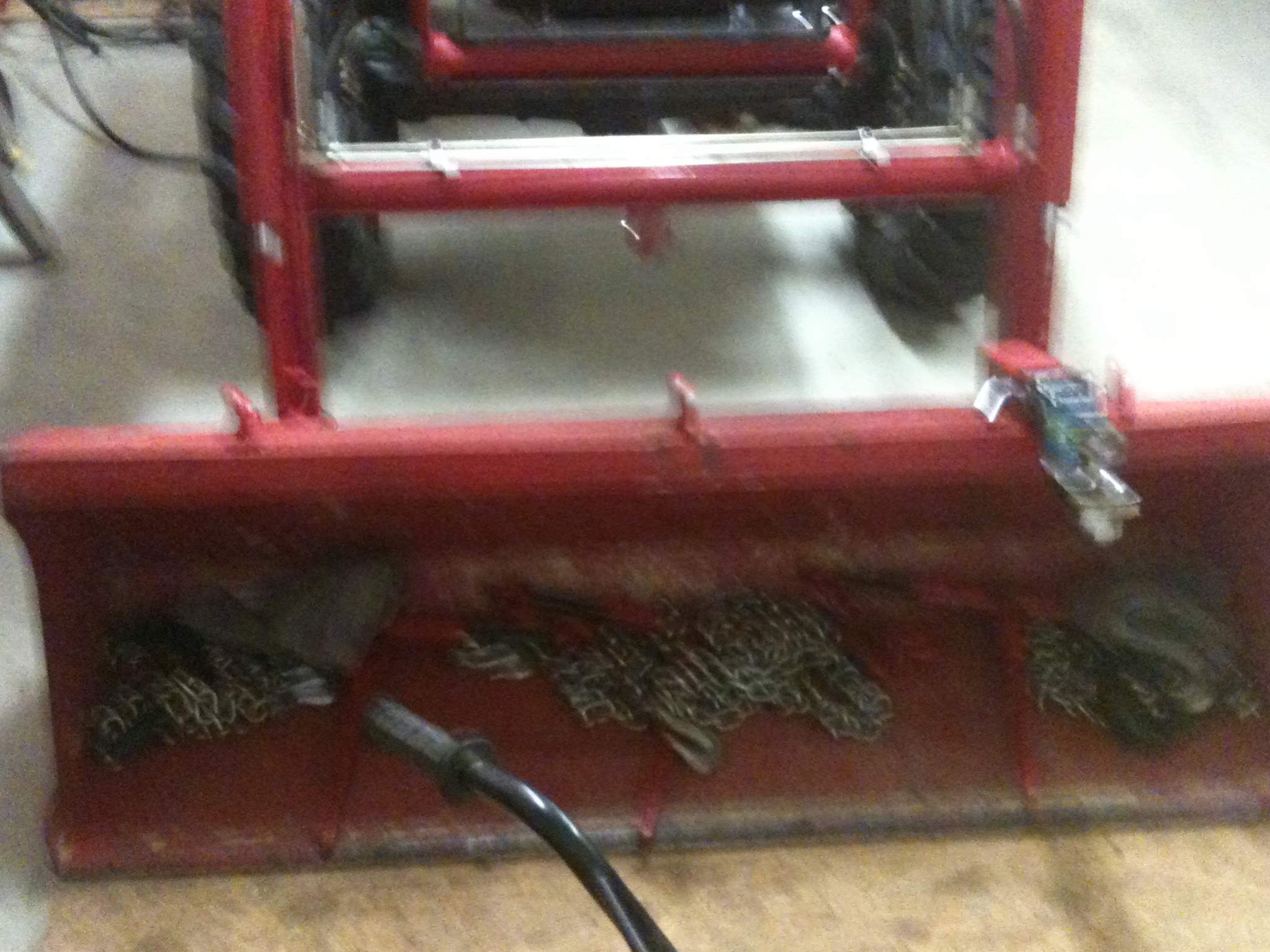

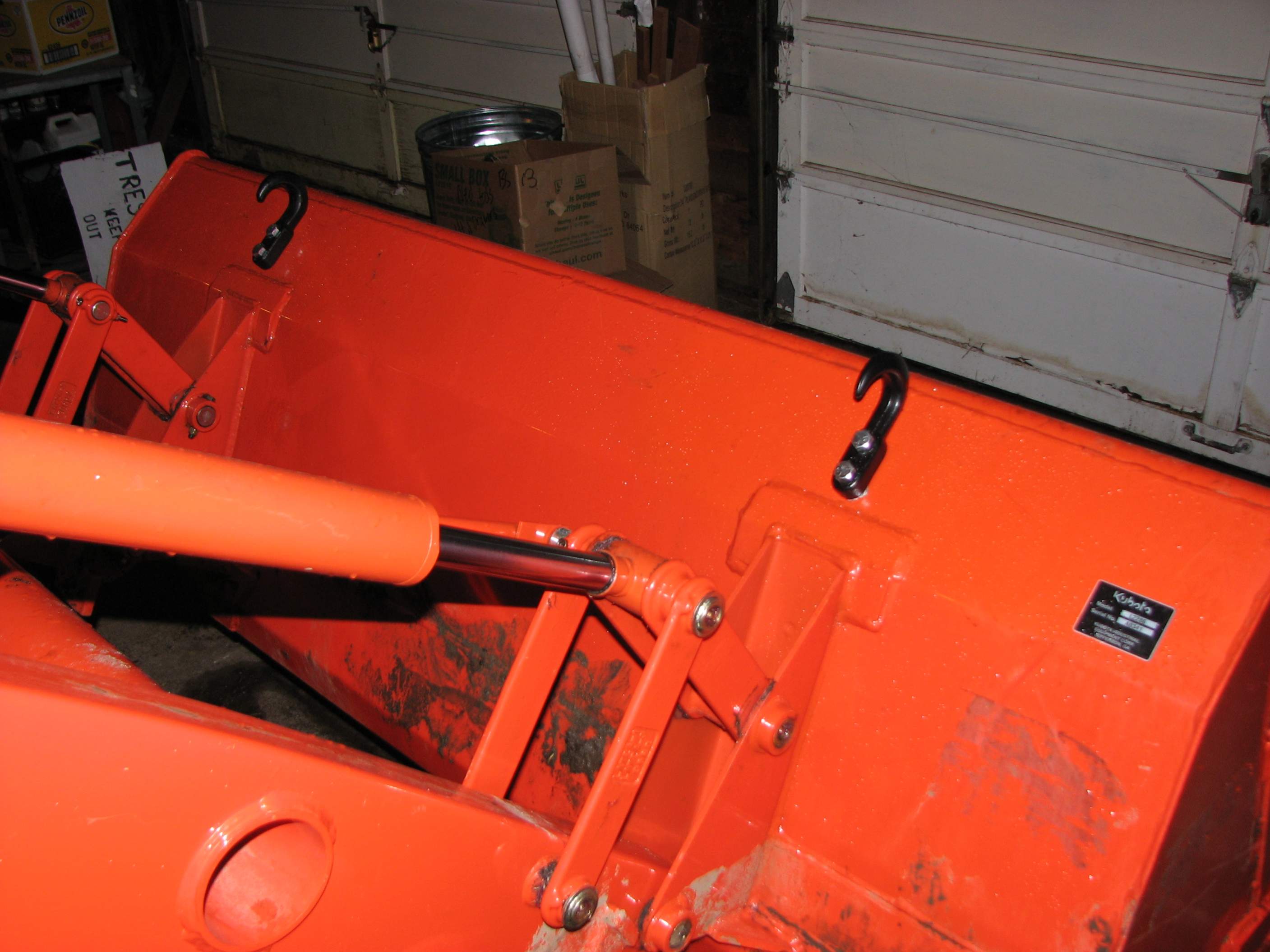

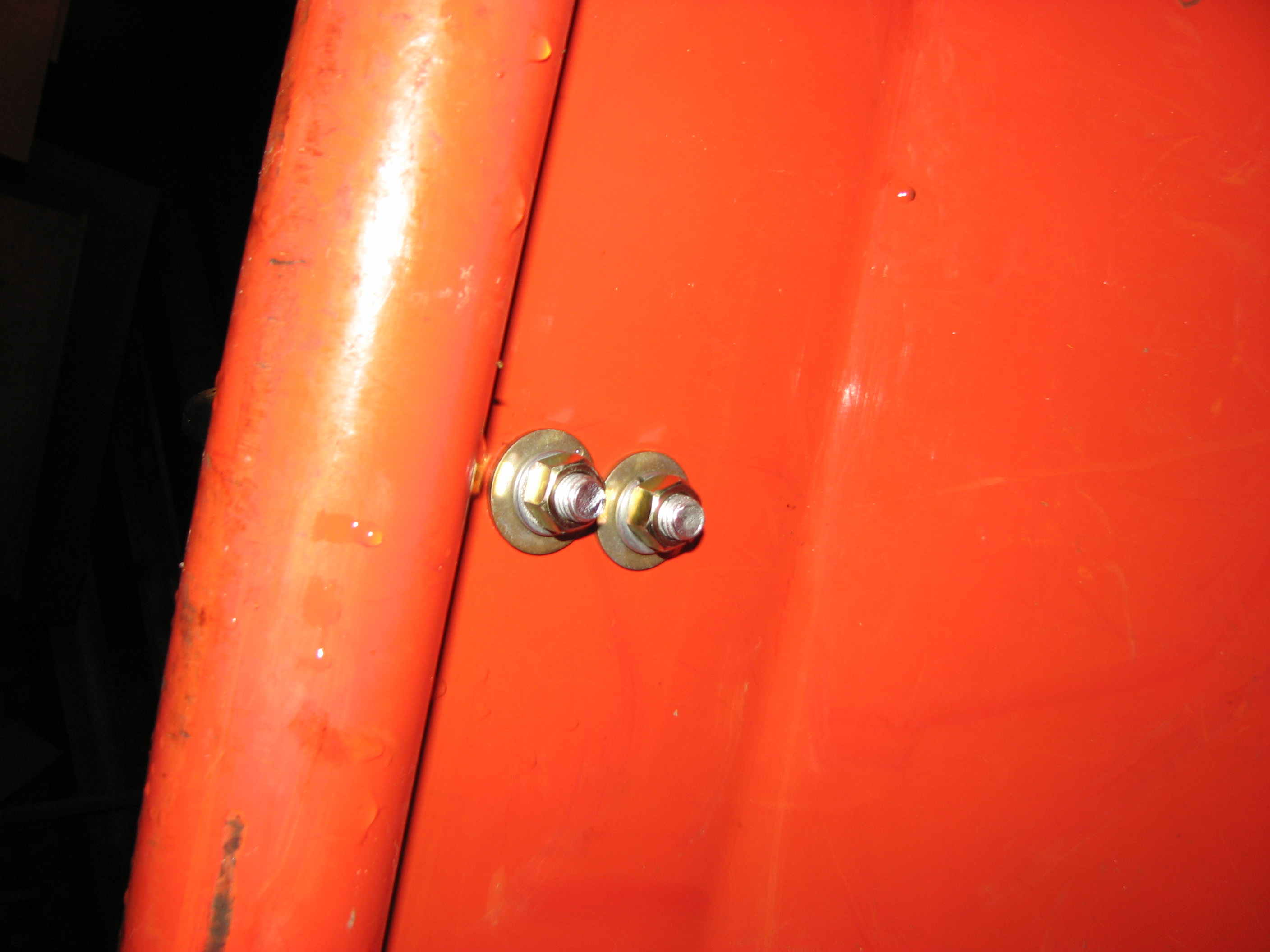

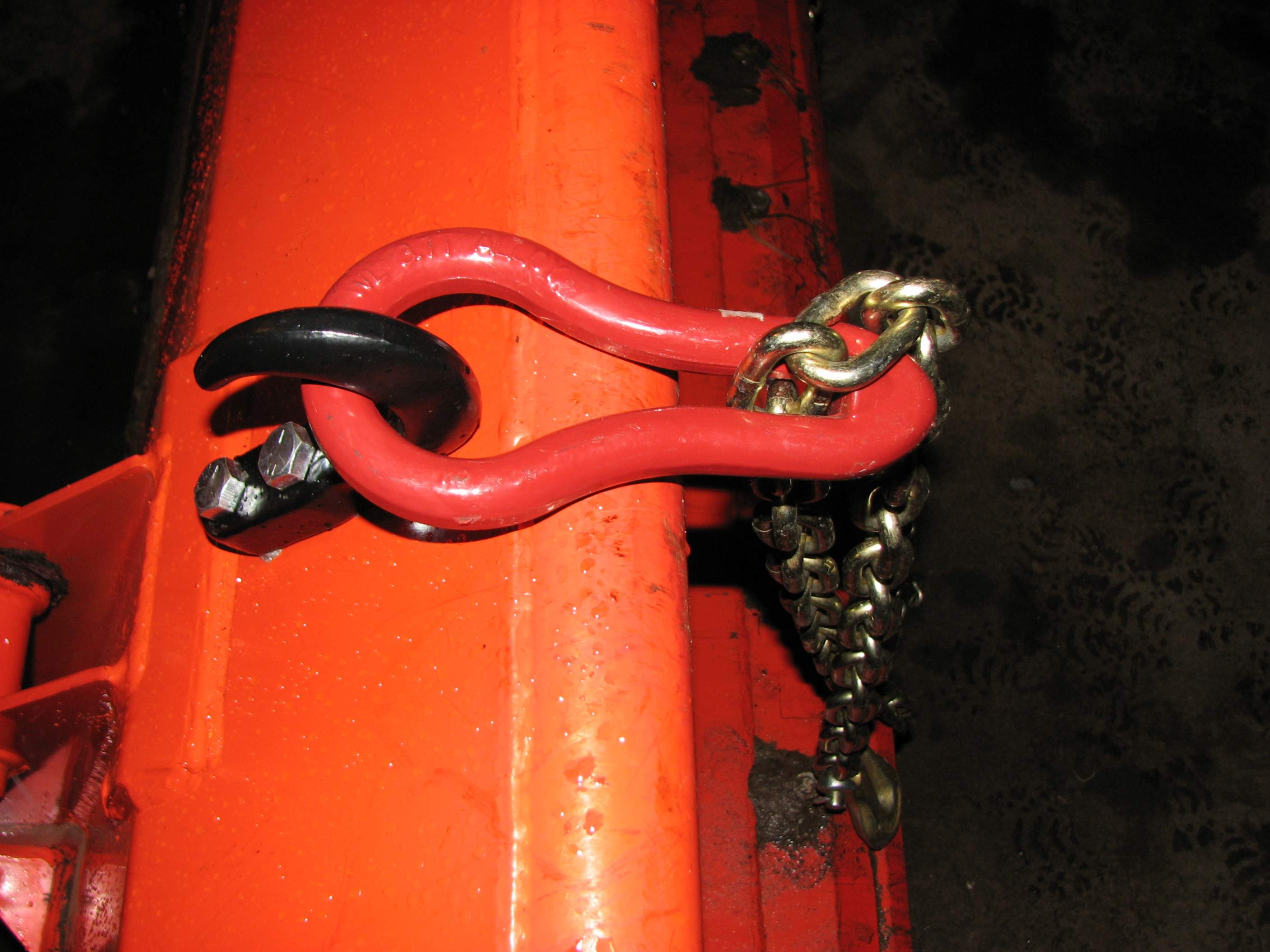

I'm new here and I have a new kubota L3540 and was woundering how everyone attaches things to their buckets on FEL? I've crused all of the photos and looked at all that showed the buckets. What have you added to your buckets to haul things with (hooks, eyes, chains, ect). I need inspiration ! ! ! Thanks in advance. David :)
   / How do you hang it from you bucket? #2

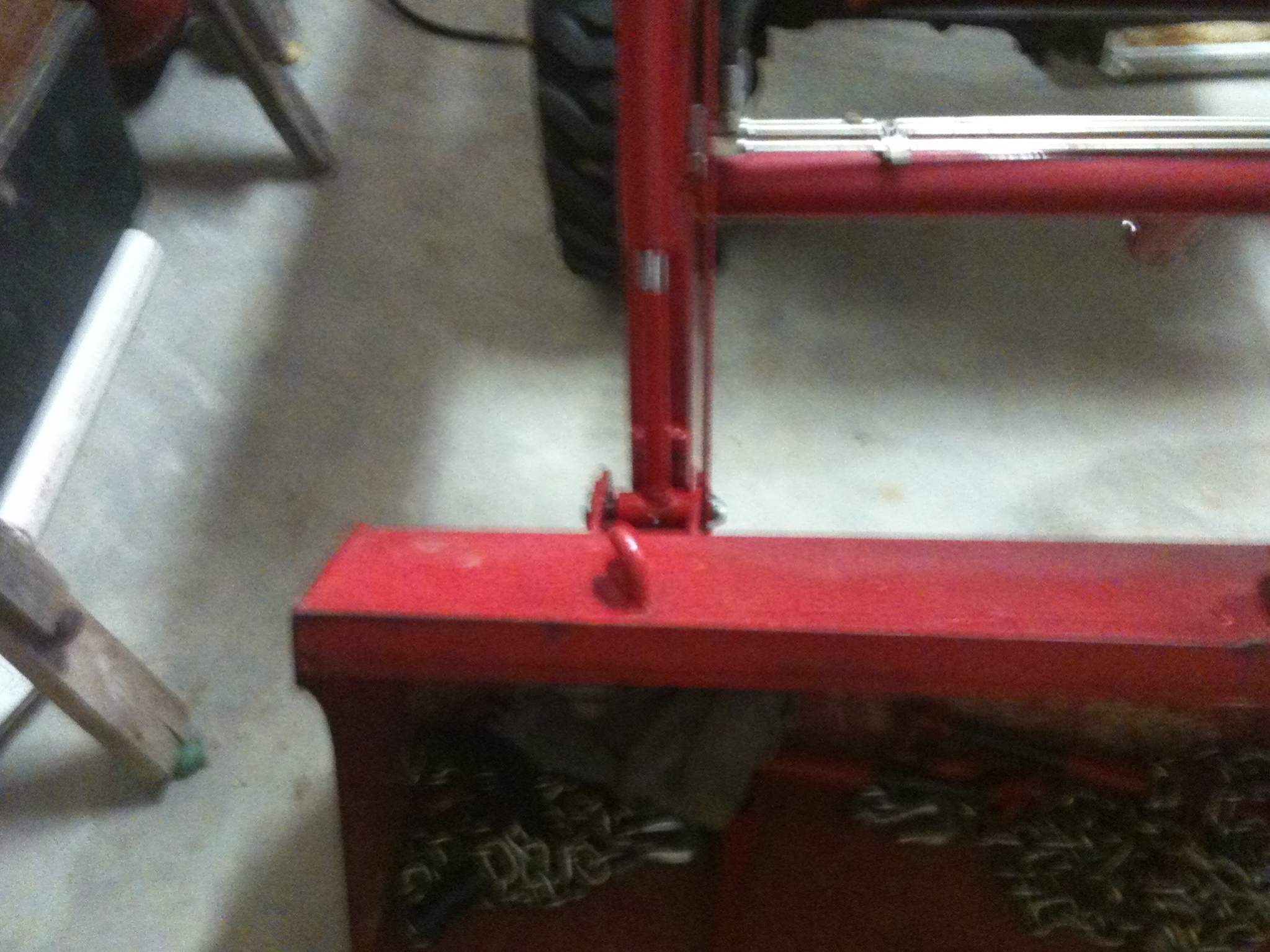

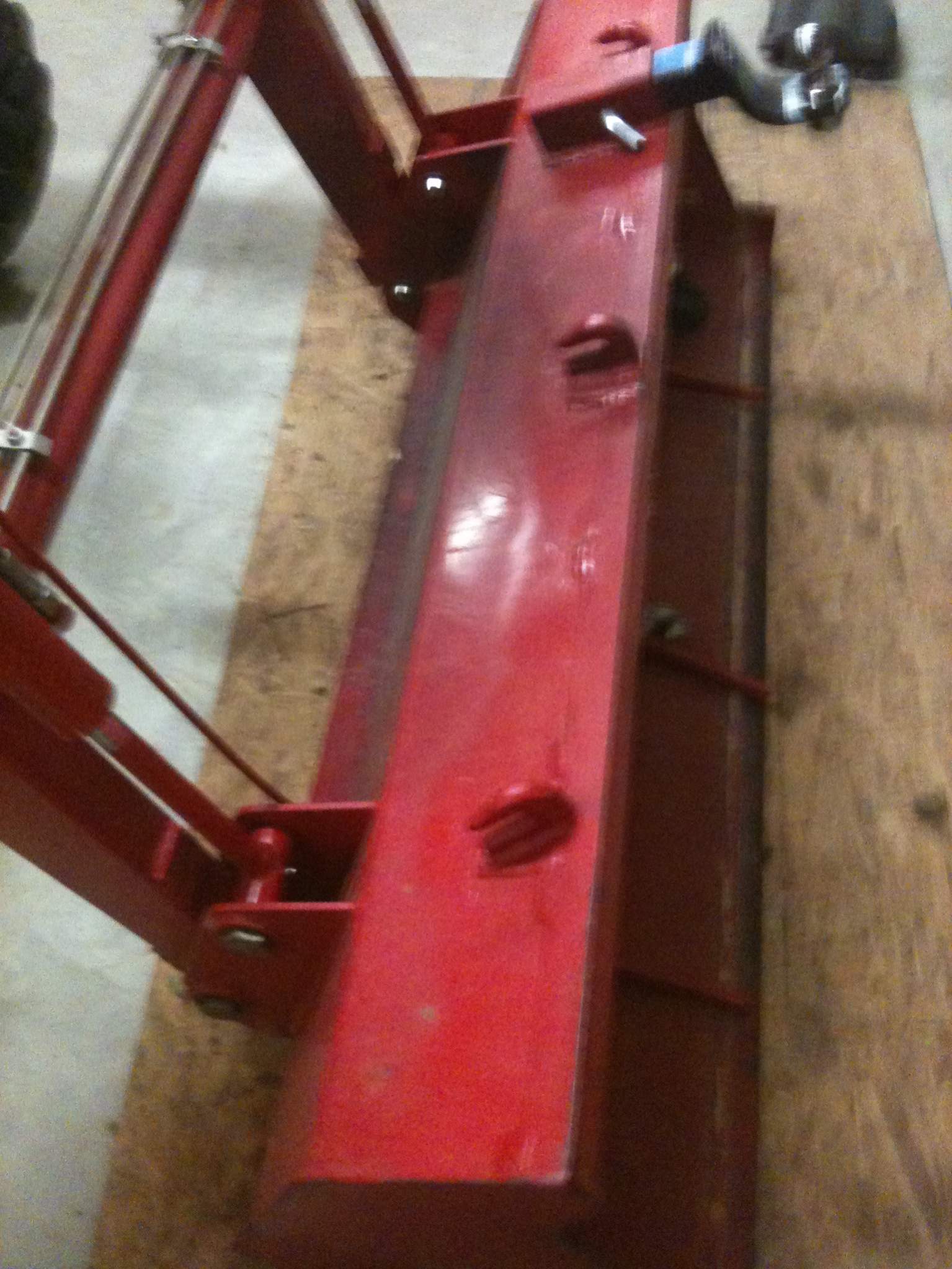

This is what I did: hooks and receiver.

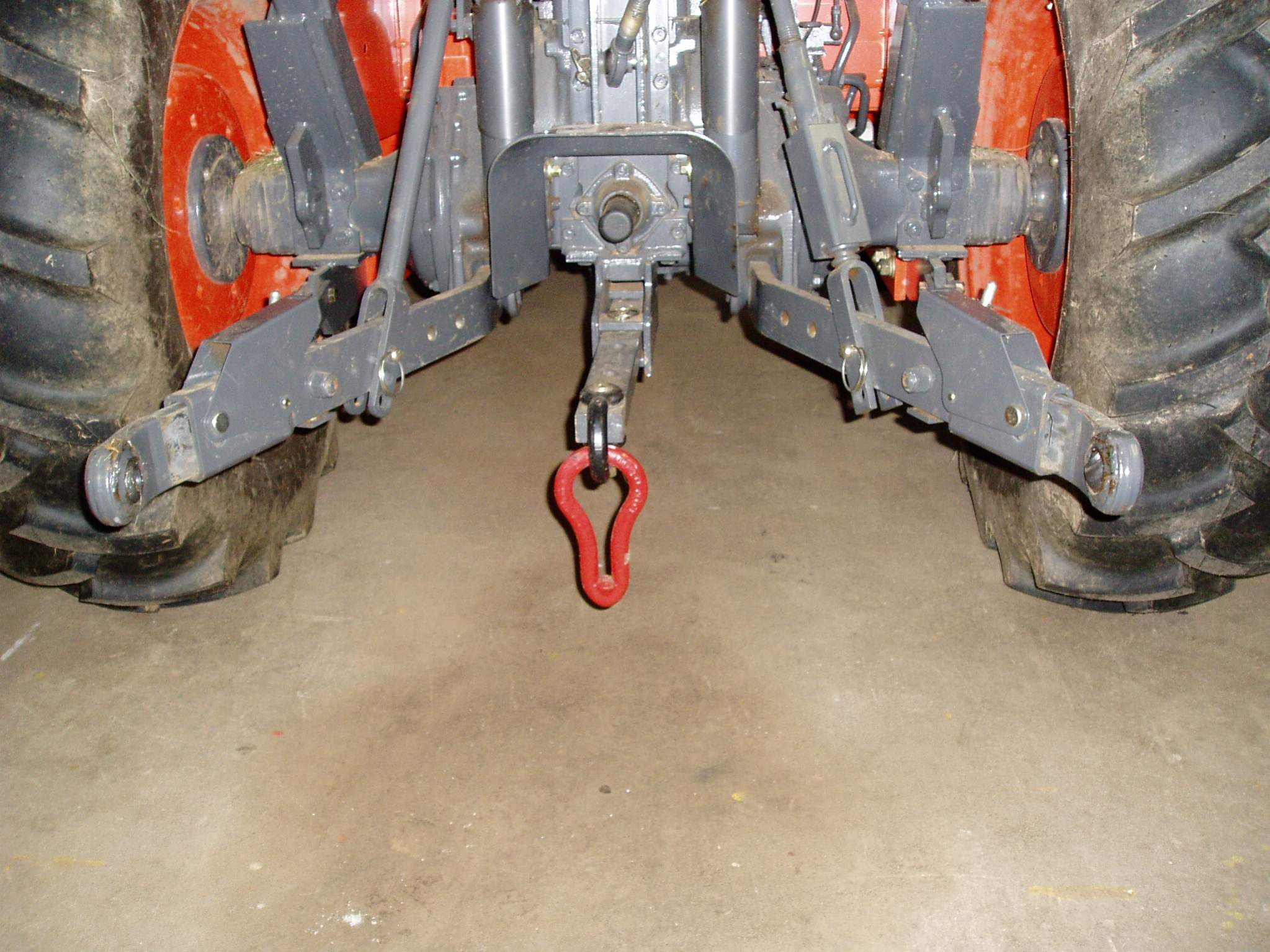

Ok! I've got to make me a tooth bar, I'm in the process of making a brush rake for my bucket now (buying materials) and think I'll modify it so they will inter-change.
Baby Grand; in the 3rd and 4th picture you have a red connector, I've never seen one like that before, what's it called and where you get?

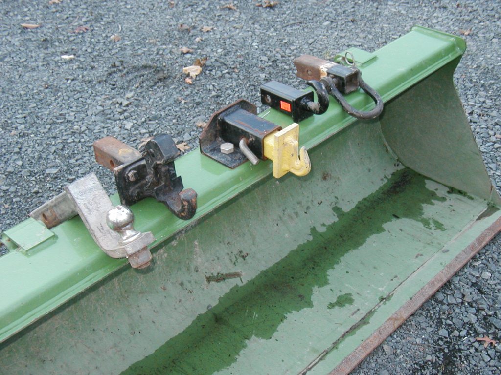

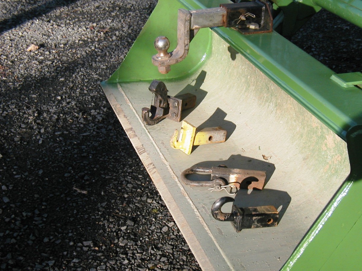

Someone on TBN built this. Many adapters.
