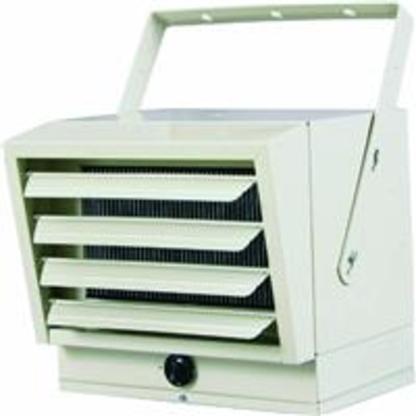

NorthernTool - hung a few of there small heaters on the wall - they have a built in fan and you can set at a temp. the fan comes on when the element is warm and ready. they work great.
