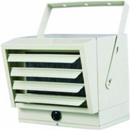

For a 1-2 car garage i install lots of 5,000 watt electric heaters. these cost about $200 plus install and work ok as long as the garage is insulated. Not the cheapest thing to run, but ok if its only occasional use.

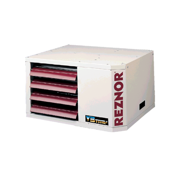

Like Grsthegreat, I have one of those forced air heaters that is LP that mounts in the corner of my shop. Its 28'x30' and even on a really cold day it will warm it up from 45 to 65 degrees in just a few minutes. It doesn't take any duct work and is vented to the outside with a small flue. The only thing is it wouldn't work well in a large shop.
