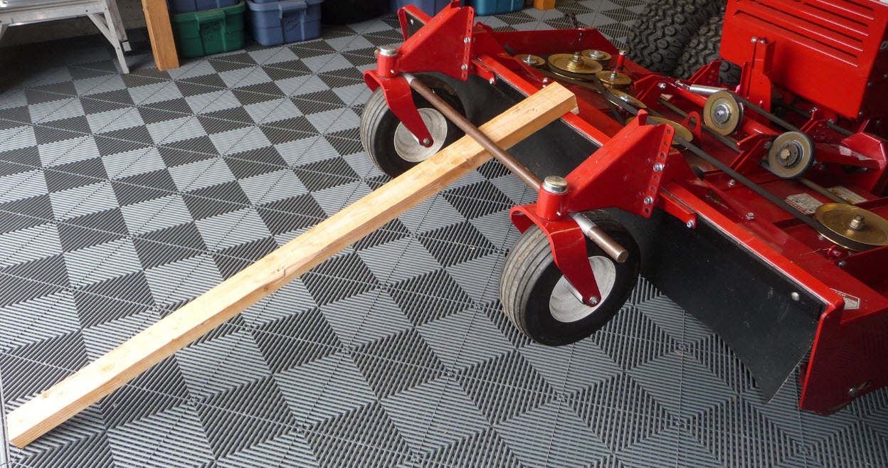

I used a 2x4 and put it under the bar like in the pic and on top of the deck. I screwed an small piece of 2x4 for a stop, and slid it under the bar and on top of the deck till the stop hit and you can lift the deck easy. mine is about 4.5 long... jim

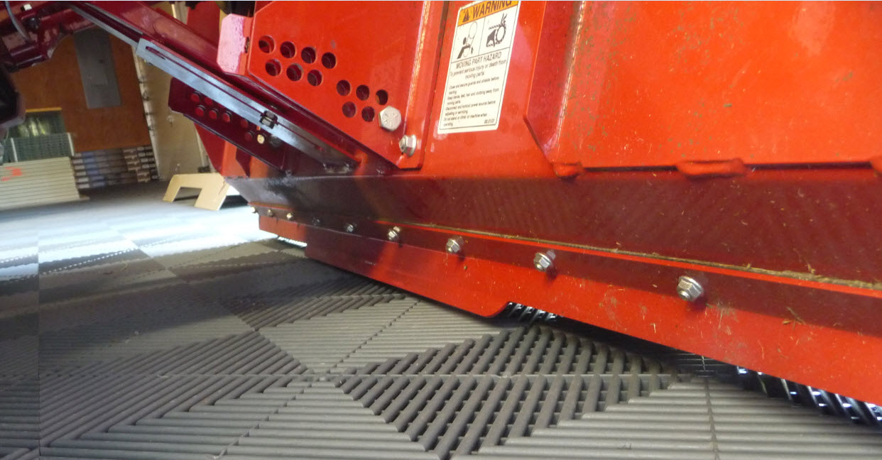

PRS - Thanks for the sharpening and balancing equipment recommendations. I wonder if your mower deck configuration is different from mine. Here is mine in the flipped-up position with the hydraulics lifting the deck as far as possible . The gap under the back edge of the deck is less than 3/16" (and the rear rubber skirt is folded forward under the deck on the other side of that gap). I suspect that something would get damaged if I did this on a nearby slope then tried to drive in either direction back to the shop.

James (johara1) - Thanks for the idea about the 2x4. I made mine as long as possible (60 inches) to get the maximum leverage. I have to slide it in from the tractor side. As you say, it's an easy lift this way. My slightly built wife tried it out and was able to lift it.
The only downside to having the pipe across between the swivel wheels, at least for me, is that my arms are not long enough to reach down over the pipe and put the pins in to hold the deck in the upright position. For a few seconds I thought about reaching in between the deck and the pipe, but then I imagined what injuries would result if I lost control of the deck and it came down with me in there. My trusty helper is usually available nearby when I'm mowing, so I can get her to insert the pins while I hold the deck up. If I had to do this singlehanded I'd have a fixed length rope dedicated to this job with a carabiner at each end. One end would go into a hole at the ROPS hinge and the other would be sitting on the hood of the tractor where I could reach it after lifting the deck to snap onto the pipe and hold the deck up while the locking pins were inserted.
Chris
I forgot to say to get a couple of tarp straps to hold the bar in place, and don't forget to make a stop from a short piece of 2x4 so it won't slip when you raise the deck... sure saves your back. ask me...lol... jim

Lots of us with bad backs around here. Chris, I have had no problems with ground contact when moving with deck locked back. My favorite "slope" for that purpose is a dressed side area of my paved driveway that is almost a 20 slope.
