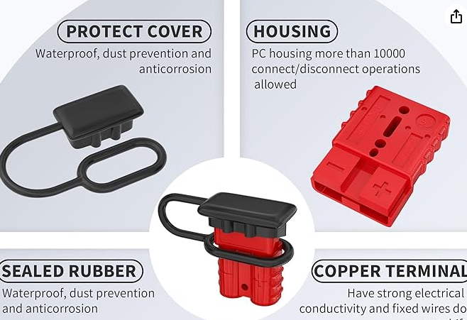

I need to put a towable wood splitter on a trailer and move it over 100 miles. I’m trying to figure out how I am going to get it up on the landscape trailer. I was thinking an atv winch mounted on the trailer hitch. But I’m not sure how to power it. I was also thinking possibly a portable winch like this one that just uses an extension cord.
Anyone ever wired up a winch for their tow hitch?

Use a portable jump start box or extra battery with clips on the lead wires.
   / How do you power a tow hitch mounted winch? #3
Depends on how permanent you want it to be. You could get a set of booster cables and cut one end off and install a plug like this on one end, the other on the winch:
Could get a spare battery and gear that up if it's something you're not going to use very often.
Use a small hand crank boat winch.

I welded a receiver hitch to the front of my trailer & used the Harbor freight 12K winch hooked to a 12 volt deep cycle battery with jumper cables. Ultimately, the battery will live in the tongue toolbox when I get everything separated/secured to protect from shorting the battery with chains/binders/etc. Haven't needed the extra battery enough times to worry about it yet.
Cable come alongs
LOL Did the cable come along one time with my Kawasaki Mule in 95 degree heat. I now have a 12,000# Warn winch and deep cycle battery on the tongue.

I used an "anderson plug", like mentioned above, off amazon. Its the red plug behind the bumper grill. Pretty solid and easy to disconnect.

For the few times that I need to use a winch on my trailer I just use my heavy duty jumper cables. They easily reach from the truck battery (extended cab dually) to the front of the trailer. Works fine for my limited needs.
