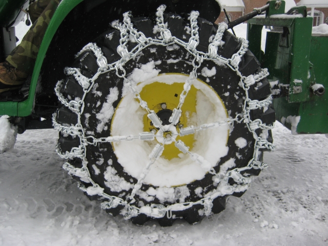

My chains are here, probably wont see any more snow this season.
I have ladder chains from Tire chains .com. I put them on this morning (never had to put chains on before) I placed them on the ground and drove on to them and lifted them up onto the tire. would it be easier to put them on from the top first or drive on to them? Also the chains maybe a little to big as one cross section overlapped the other end. Not going to cut just yet, making sure I have them on right first. I also got the spring tensioner, After tightening everything the still seem a little loose. Any suggestion would be appreciated as I never had to install chains before.

It sounds like you and I have the same set up. I jacked the rear up and pulled them up and over. The things weigh 75 pounds, it was work. On the tensioner, I used a ratched strap to pull on them to get the tension I wanted.
Wayne
