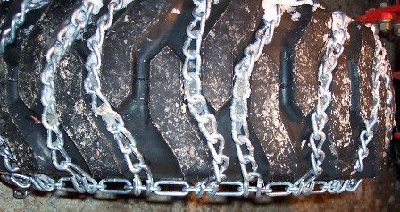

A pic of your chains with all the cross chains settled between the lugs would be neat to see. :)
I expect I'll try loosening them a bit.
