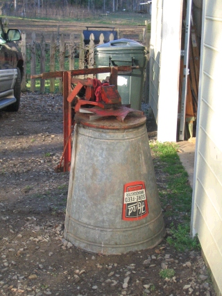

I just picked up a F160 Herd Broadcast Seeder at an auction today. This one was also frozen up with some rust and a lot of crud. Was able to get it turning this afternoon but have not put it on my tractor yet. Have seen the Herd website but don't have an "owner's manual" or any such thing. Can you tell me anything about it? Do you have the same one?
