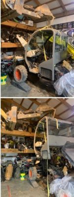

how do you remove the cab on a tool cat

Among other things....remove seats, F&R fenders, coolant reservoir, center console, disconnect battery, disconnect electrical items like fuse holders and grounds, disconnect steering pump, unplug a bunch of electrical connectors, disconnect heater hoses from core, remove bottom engine cover, remove cab bolts, remove doors, put strap through cab and lift with hoist.
First, get a manual for your series and follow steps.
   / how do you remove the cab on a tool cat #4
The manual walks you through exactly how to do it. Was very helpful. Why are you pulling the cab? I had to pull mine to determine which hydraulic hose was leaking and have access to replace it.
