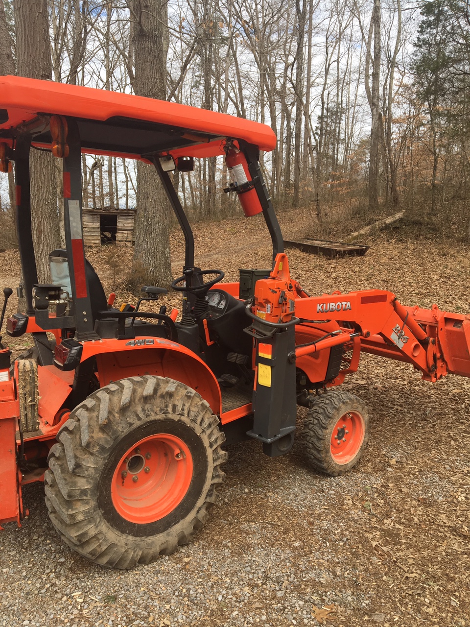

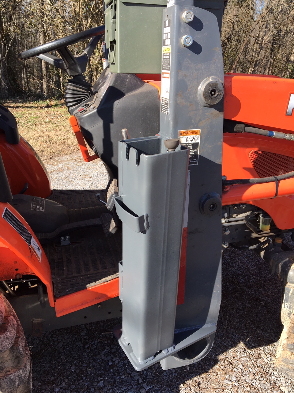

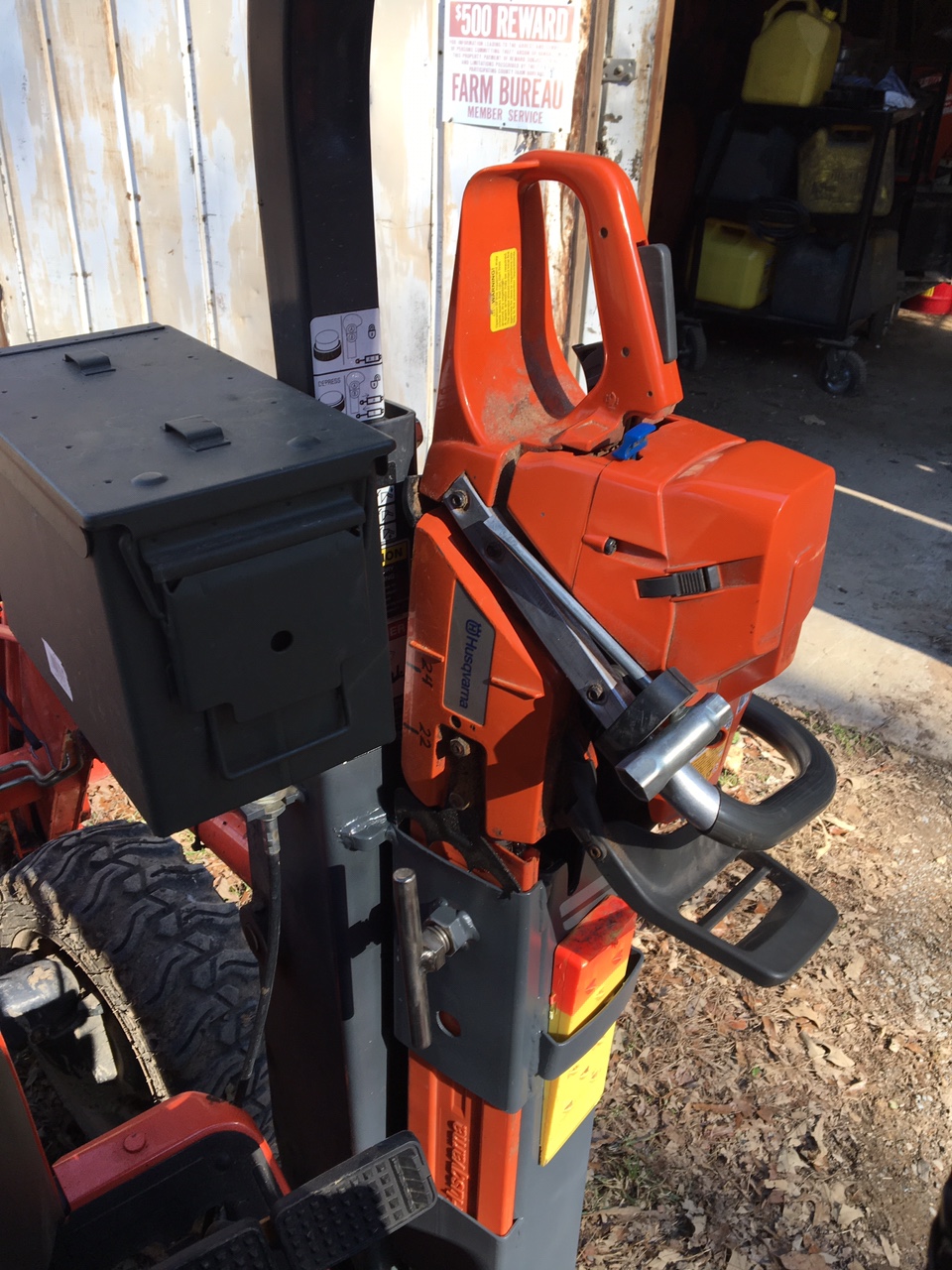

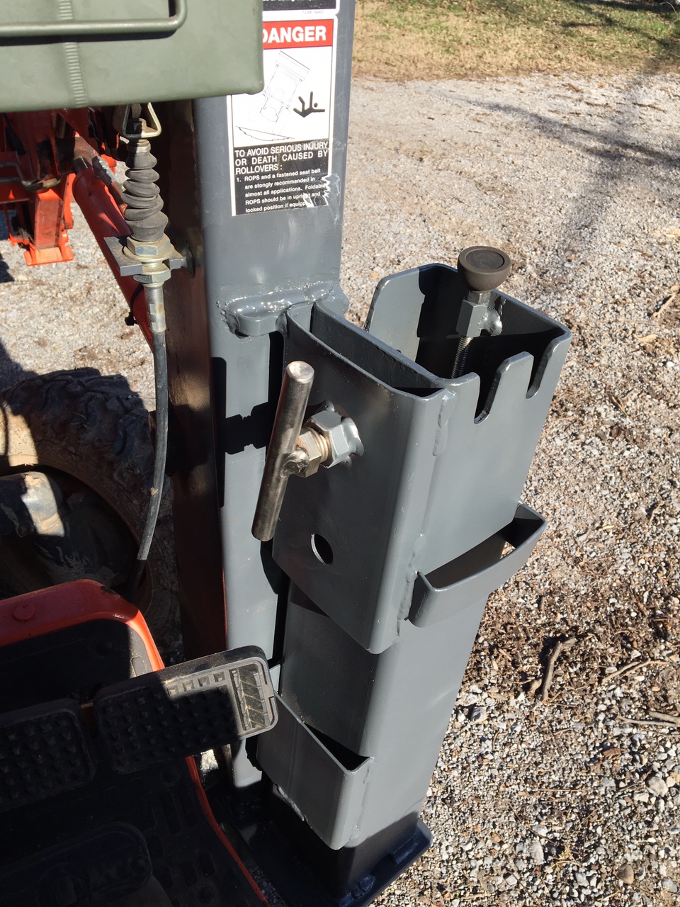

Smokeydog, very interesting, and beautiful fabrication work. But I'm not sure what I'm looking at in the pics! Could you post a wider shot, and maybe a description of what you've done here?
The chainbox is a drop of 5x5” sq steel tube. Bottom is 1/2” plate. Welded to the loader support. Ample drain holes in bottom and spaces to blow debris out. Doubles as long handle tool carrier too.
The chainsaw holster on side. Locking bolt with spring antivibe secures bar with plastic bar guard in place. Slightly out of plumb with the loader frame to reduce lower footprint and allow better clearance for the saw. Note rubber adjustable foot to support saw body. Not necessary but I like it. Loop for felling wedge or tools like a hammer.
Made to be tuff and not in the operators way. Safely carry chainsaw, chain, tools while operating Kubota B26 tlb.

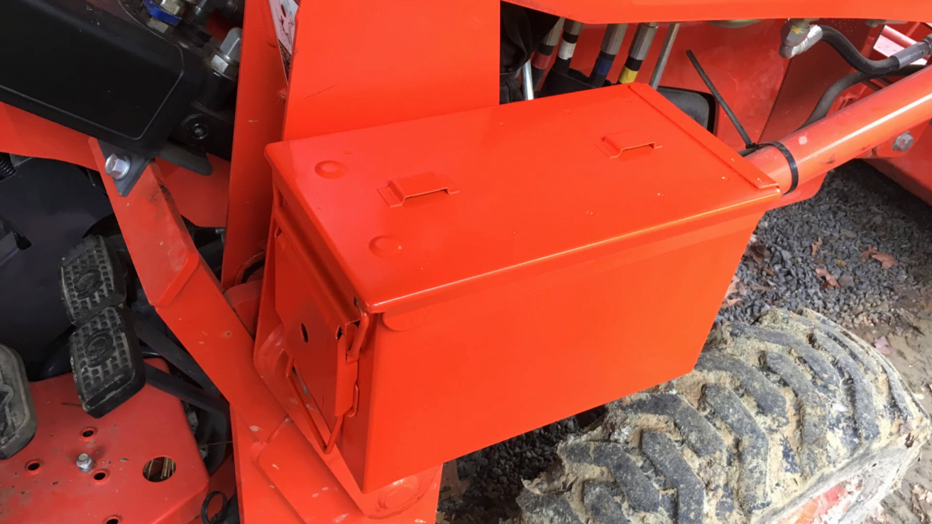

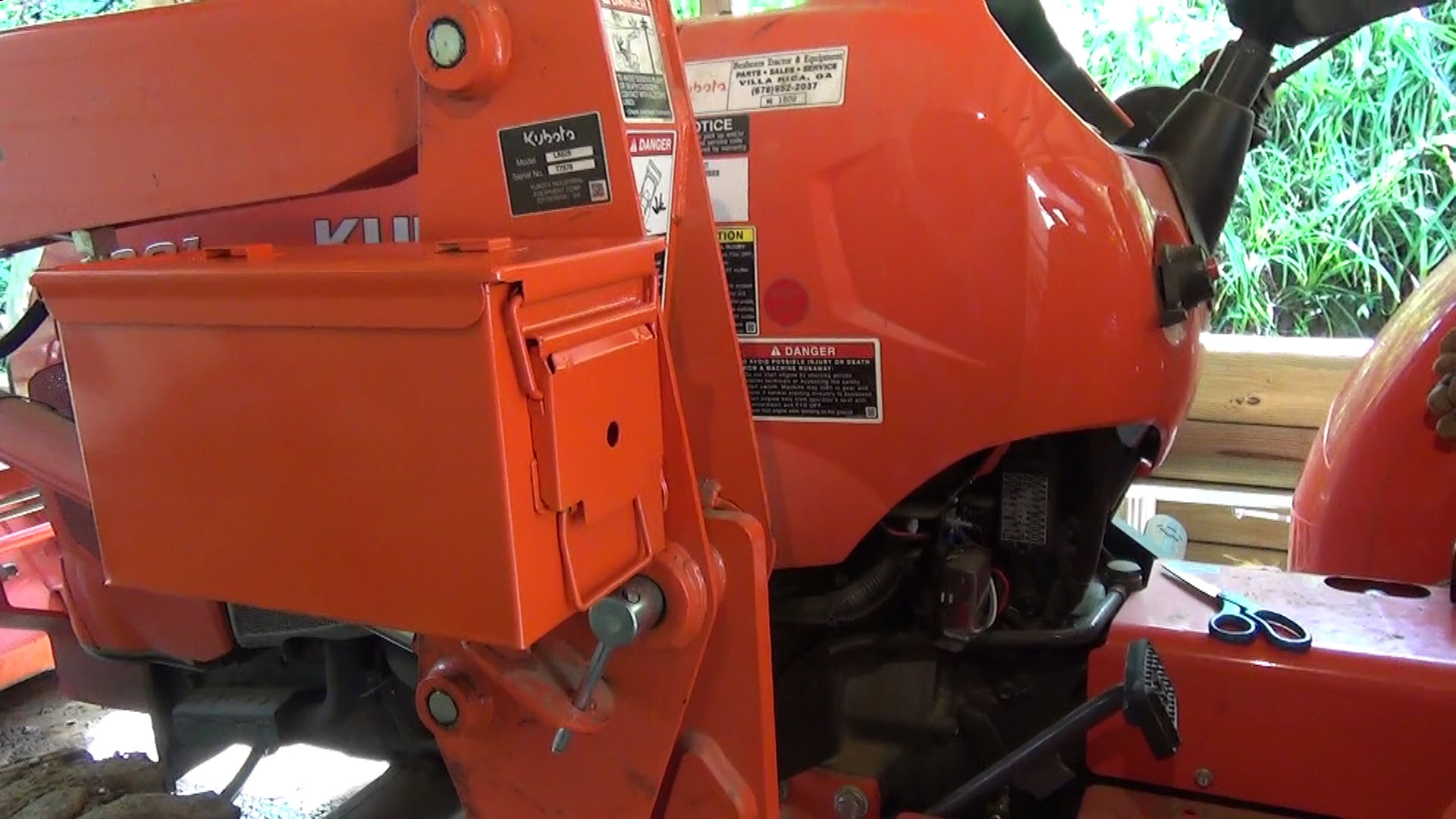

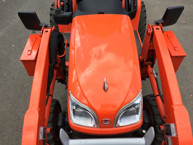

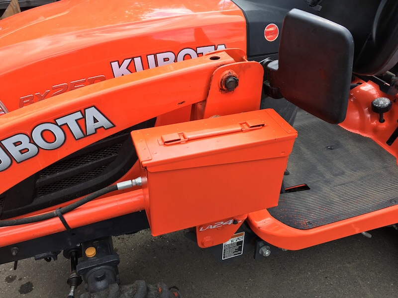

I like to have my chain with me at all times but haven't found a good place to put it on my tractor. How do you deal with this? Thanks.
I have two chain boxes, one on each FEL tower, made from 50 cal ammo cans. They are attached with JB Weld and so far have held up well over 4 months of hot and cold weather and riding over rough terrain. Each one holds a 20' 20 lb logging/towing chain. Time will tell if the hold for the long term. Some pics are attached and I have a video showing how I mounted them:
Adding Chain Boxes to My Kubota Tractor: Adding Chain Boxes to My Kubota Tractor - YouTube
So far they have been very handy to have in the field!
