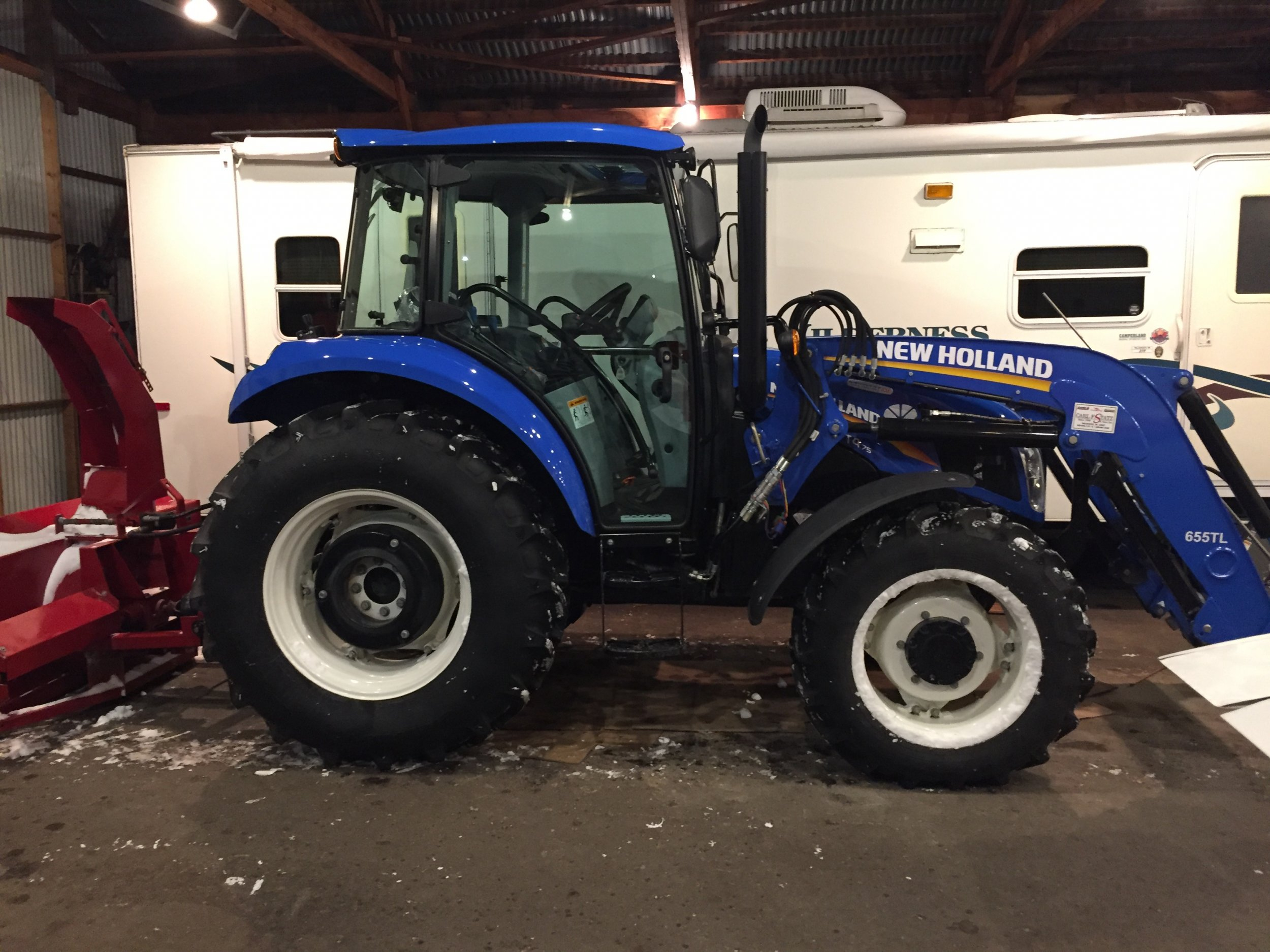

I have a New Holland Powerstar 75 that I purchased in 2019. I am the first registered owner. Some say that I should call it a 2019 as I am the first owner. I found a sticker on the engine that it was produced in 2017. My purchase agreement did not state a year just the model.

Engine may have been produced in ‘17. Look on the cab floor, frame for another “chassis” decal. Or call dealer with serial # and he will give you year

Supply parts can be manufactured any time. Unit serial number is recorded in the year manufactured. Non automotive suppliers don't emphasize the model year like auto/truck vendors do and in the resale of non such items, condition is the key, not the year it rolled off the assembly line.

On tractors there are no registered owners and model year is irrelevant to most people. It’s not a car.

The “same” tractor as mine made a year later has:
the exhaust stack on the opposite side of the tractor,
tier IV components,
a reconfigured operator station,
an electric PTO switch on the right instead of a manual PTO clutch lever on the left,
a relocated fuel tank,
a redesigned hood,
redesigned fenders,
relocated battery, and
very different shielding over the transmission at your feet.
These are only the things I noticed different in a quick preview. I’m sure there’s other stuff.

Any competent New Holland parts counter person can give you the final build date of your tractor if you give them the complete serial number. Yes, you need the serial number to have any chance of getting the correct parts, even filters. When I worked at the dealership I wouldn't look up parts for late model New Holland equipment without a serial number. Many people keep photos of equipment serial number plates on their phone.

The engine will certainly have a date of manufacture on it as the engine is what has to meet EPA emissions regs for the calendar year it was made for installation into new equipment. That is different from passenger cars where the regs the engine must meet are based on the model year of the car it is installed into. The engine in your tractor may have been made before or after the tractor was. The serial number is the important thing with tractors. Generally the date of manufacture will be encoded in the serial number. For a newer John Deere tractor with a 17 digit serial number, the date code for the year is the 10th character. Some other manufacturers have a numerical serial number range for specific years.
