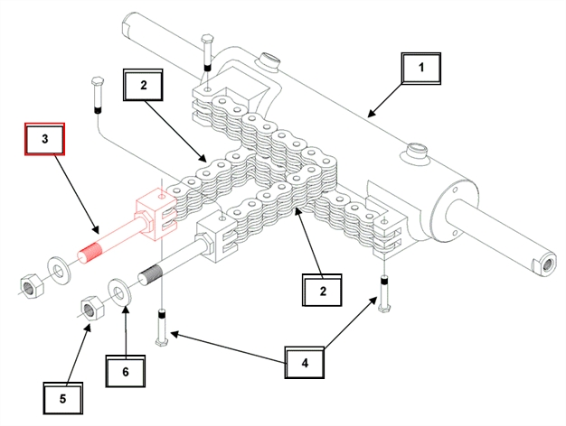

How do you tighten the swing chain on my 3716 backhoe
   / How do you tighten the swing chain on my 3716 backhoe #1
jimbob75
Mar 18, 2025
1
3016 mahindra
How do you tighten the swing chain on my 3716 mahindra backhoe
   / How do you tighten the swing chain on my 3716 backhoe #2
From the parts catalog, looks like you need to tighten the nuts #5.
   / How do you tighten the swing chain on my 3716 backhoe #3
If the "Nut 5" doesn't work add some washers on bolt 3.
