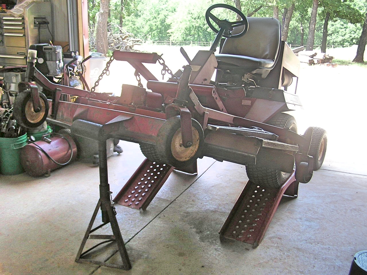

The TORO doesn't have a flip up deck, so I put the car ramps behind the front tires and back up. :thumbsup:
   / How do you tilt mower deck up on Kubota F-series? #5
Pretty good, I will try this on my older Grasshopper witch does not have a deck flip or lift either!
