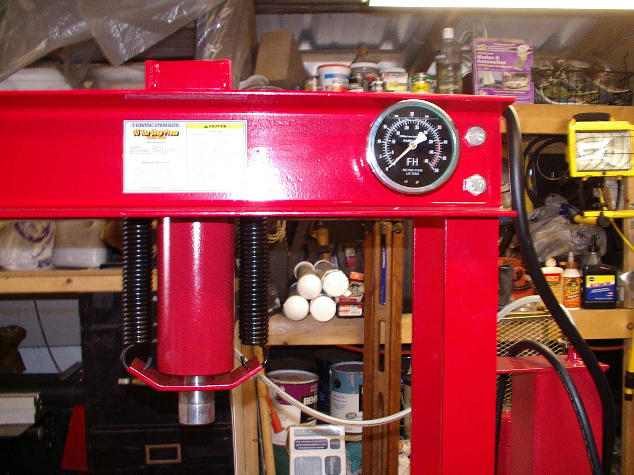

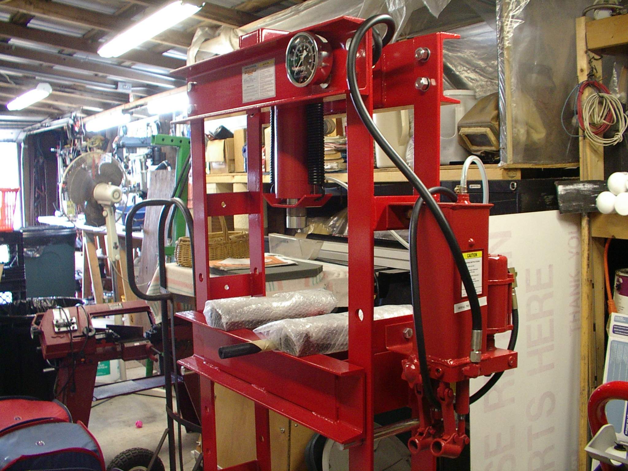

I used to think a vise or concrete floor and a sledge hammer was good enough. But I truly knew it wasn't. Take a look at Larry G.'s projects. I knew I had to get one then if I wanted any decent results. This is a 35 ton air over and it will do more than anything I have ever needed.
A piece of "C" channel with flat stock welded on the end makes a great female die portion. Larry made an anvil for me that fits over the round press shaft. I have bent 1/2" x 4" flat with no problem. This press gets used constanly.
I am so glad to be out of the stone hammer age. Gene

Nice looking piece of equipment!!! Do you have a press brake? I am thinking about getting one from Northern (also looked at the Swag) Don't you have to use one to bend flat stock?
