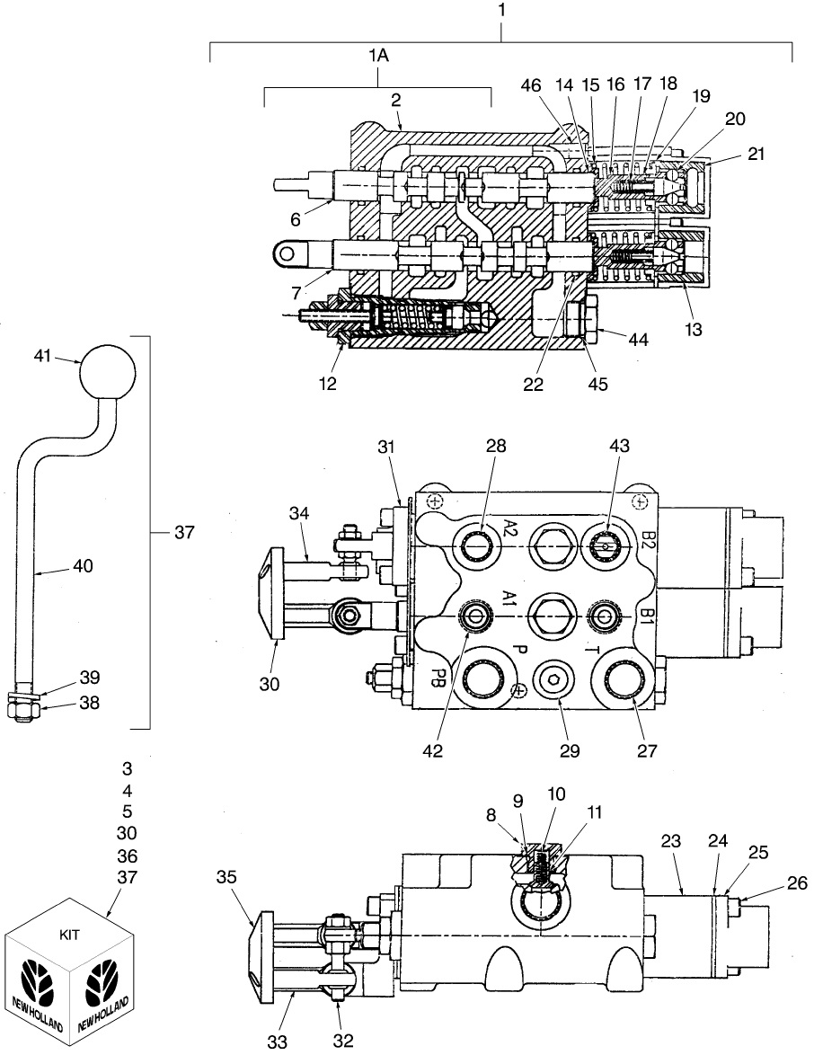

I think the illustration below is your valve. Can you tell us what parts you are having problems with? If it is not the valve, then a photo would sure help.
/ how does 7308 joystick work?
I like your design much better because your item 38 is a nut that would hold the lever, onto the mechanism I believe. Mine doesn't have a nut but is a ball & socket type of design where essentially the bottom of the lever is the ball & fit's into a hole in the mechanism. I welded 2 thick washer together & it seems to be working & keeping the ball from poping out of the socket so I cant take a picture because you won't be able to see anything since the washers are in the way. I can't take it apart until it breaks again.
