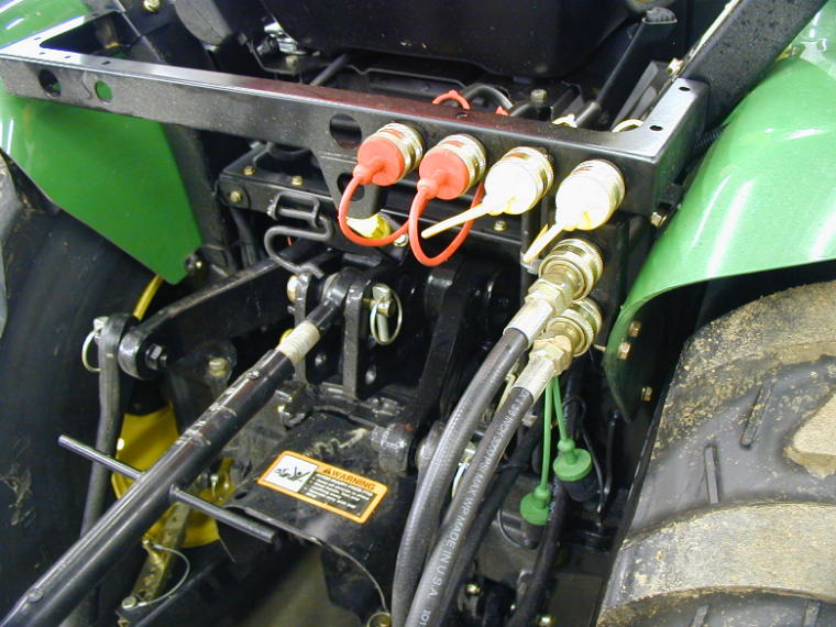

Here are 3,4, and 5 functions at the rear. Personally, I'd rather have the lower RH pair in the main bar, but I'm not sure if that is possible with the electric diverter kit.

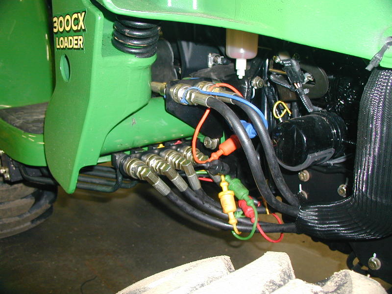

The hoses from the RH rear pair run up to the orange and blue pair here.
You can also see the diverter block, and lines. Could use a skid plate here.

KennedyDiesel; Great photos. Appreciate it. Does the electric diverter turn off hydraulic pressure for just SCV 1&2 and provide that flow to 4&5? Since SCV #3 is operated from the lever near the draft control how does the electric diverter affect the use of #3? Thanks again. AKfish.
