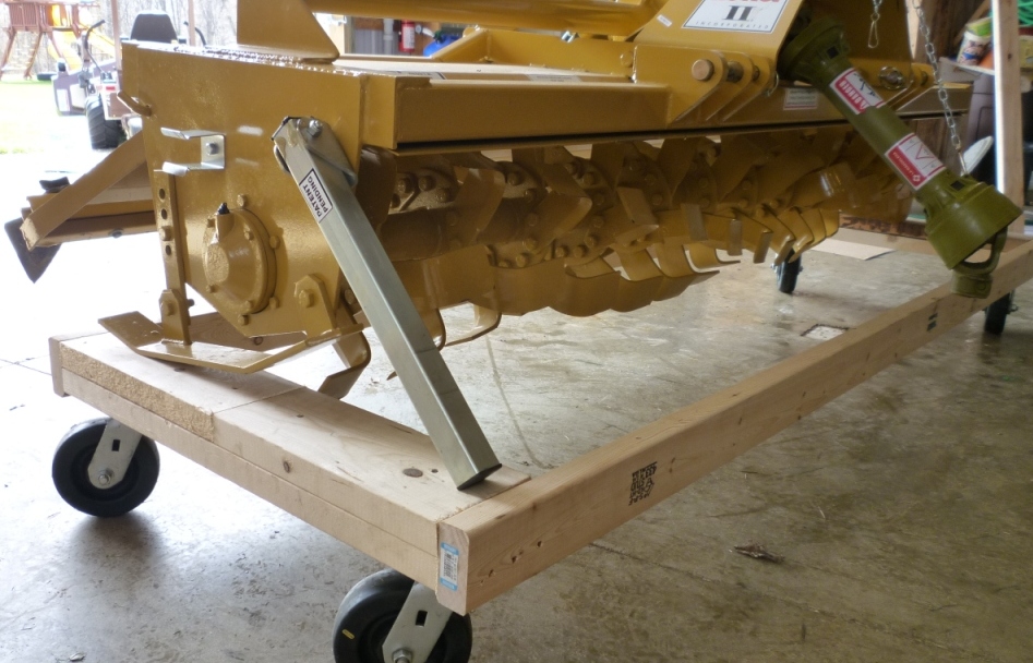

I've tried the support leg but it keeps slipping and the tiller falls forward. I even welded a sharp stud on the lower end to keep it from sliding forward. nothing works. Do you guys use something else or move it to a different location??

I took a pic of mine tonight. I think this is the same thing billsh96 is talking about or at least it should be similar.
/ How does the KK storage leg work? #8
If the leg looks like this one, it should hold fine. You can see in this picture it holds the tiller tilted back on it's shoes, and the leg is very solid. You have to hinge the leg out and around as you rotate it to get it into the proper position, and then it locks in place against the stud welded to the side of the tiller. The stud is there to stop the rotation and hold it in place so it doesn't slide.

If it isn't holding, you've got the leg folded the wrong way. Fold it the complete opposite direction, then rotate around again so the leg faces forward. If it doesn't seem right, rotate around in the other direction. It only stops in the correct spot one way. The other ways won't stop the leg and the tiller will fall.
NSPEC: You are exactly correct, The Leg only holds the tiller from fall over in one position (when the metal stub sticking out the side of the tiller keeps the leg from rotating). My fault, operator error.......
