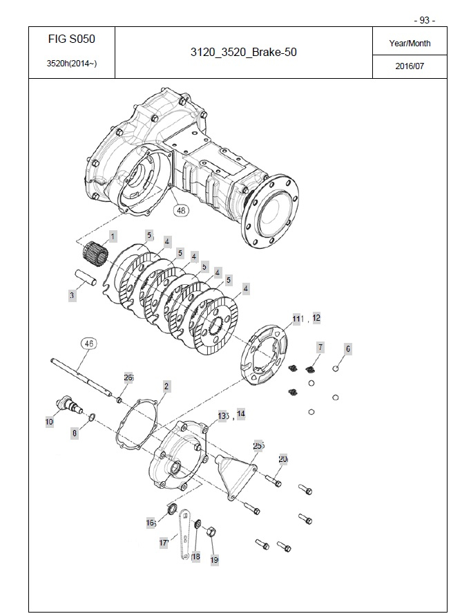

I have a 3620h ... at times i forget i have the parking brake on which drives me nuts. I'm considering wiring an alarm to remind me.
I was watching a video on international utility tractors and they said if u ever had to replace the parking brake its like a real crappy job, I was just wondering how it works on the hydrostat bransons if its similar to the international or some other type of design.
   / How does the parking brake work? #2
The brakes on these tractors it's a multidisc setup inside of each rear axle housing that runs under an oil bath, hence the "wet brake" name and why it's important to run the right hydraulic oils.
It's almost like a clutch pack really, although, it's mechanically operated, instead of hydraulically. The parking brake lever just actuates over the brake pedal linkage.
Depending on the tractor, to replace it those discs, it requires the removal of each rear axle housing from the tractor. Not that complicated but the parts are heavy and somewhat awkward to hold on. This also requires draining all of the fluid, so it doesn't make a mess. Others have a cover, like the older 3520, that's easily accessible and doesn't requires to take entire housing out.
I don't you caused any damage to it, as wet brakes can take a beating. It happens so many times to most of us, but a buzzer or something, is definitely a nice idea. Does that tractor have a parking brake light? On mine, the switch doesn't make good contact when it's dirty from dust and whatnot, and won't light up when I apply the parking brake. I have to work the lever up and down till it starts working again.
Here is a picture from the parts manual on the pre 2021 3520H. I don't know how different are the new 2021 models but I'm guessing not much, at least, on the brake setup. Part #4 is the friction discs and part #5 is the steels discs in between.

Thanks for the detailed explanation, Pedro. Those wet brakes are pretty tough and you would have to really do some serious abusing to wear one out. Usually you can tell if the parking brake is still on because your tractor doesn't have enough power. Sometimes in low range I leave the brake on on purpose to keep the tractor from creeping when hooking up implements or doing precise movements. Therefore I don't think I would want a buzzer because it would just be annoying.
