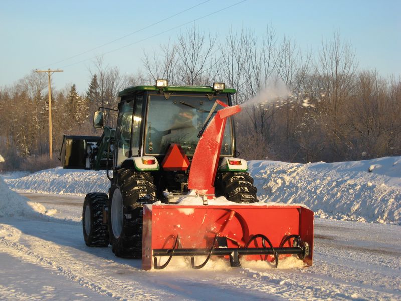

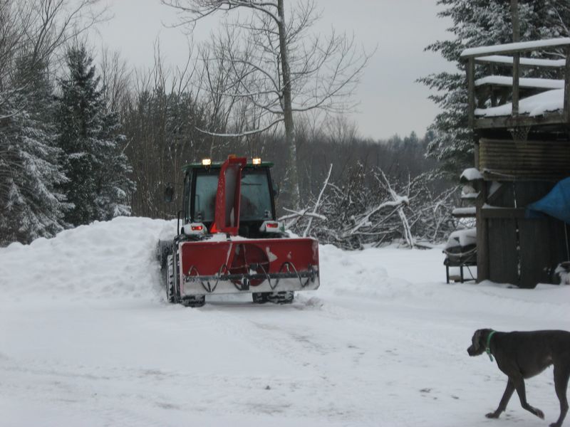

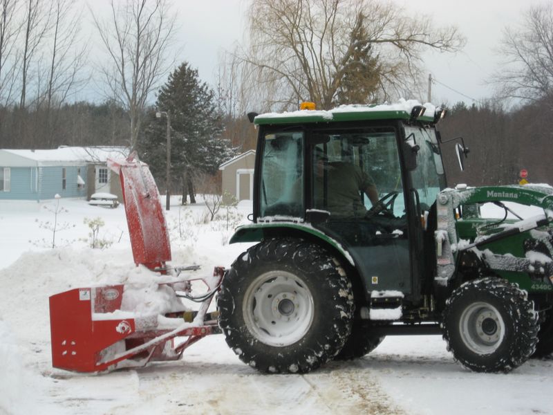

I have only clogged my blower once and it was my own mistake. It was alot of slushy ice and when I was backing into it I accidently hit the throttle lever lowering it and it clogged. I can tell you what it took me about 20 minutes or longer with a steel bar poking at it to get it cleared. Of course with the PTO shut off.
So I can reccommend keeping RPM's up maybe even a little higher than usual. Move slower so it does not clog. And use some kind of spray like pam, silicone, or fluid film. I like fluid film the best. It acts a lube and rust protectant.
