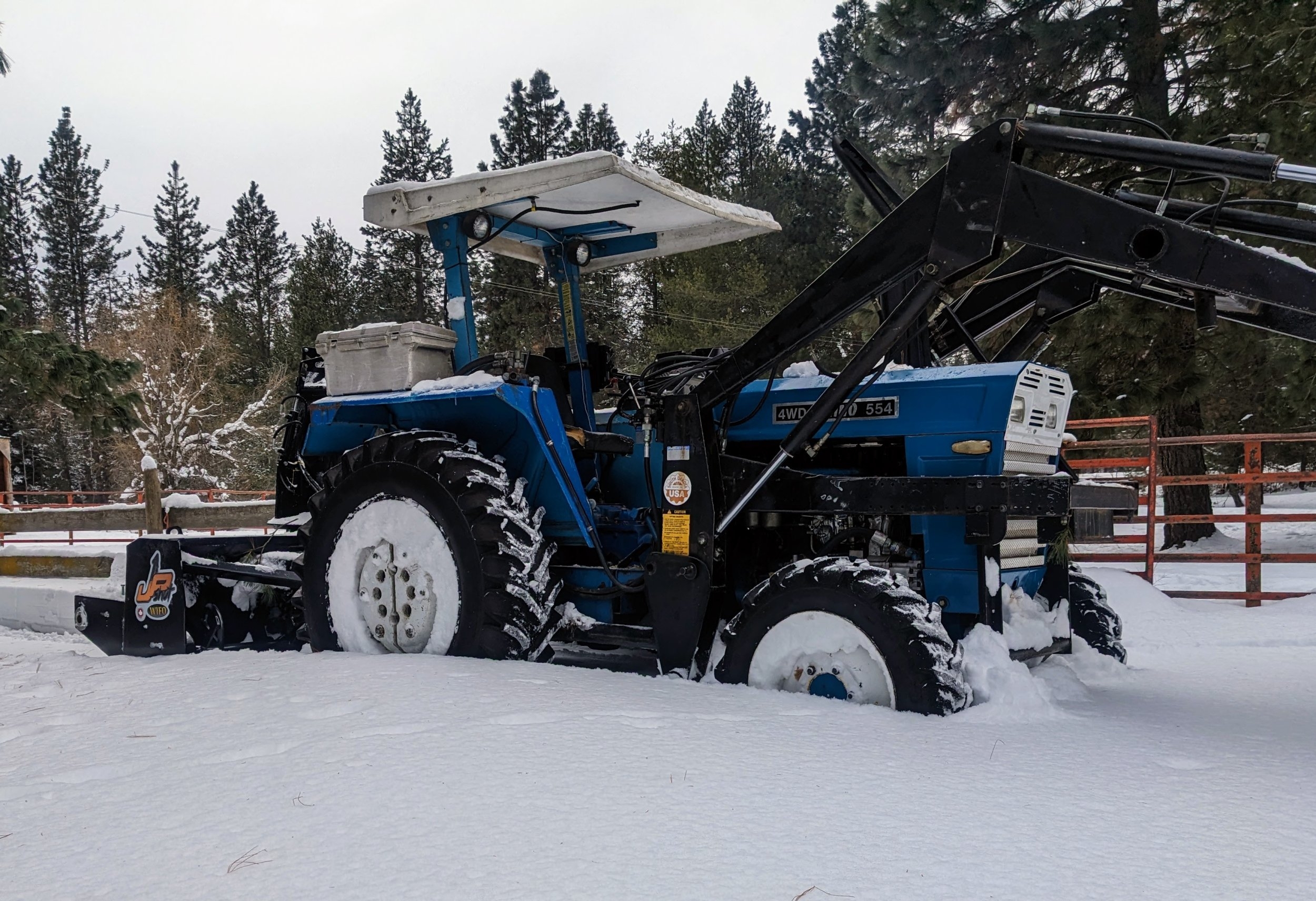

I am sure over 2 feet of really wet snow would make extra work . I am a believer R1's are better for blowing snow and maintaining traction unless it is Ice underneath. I stopped to take a pic.
Have only had the inverted 2 years but have not been stuck yet.
What did the influencer not like about the Frontier model you are looking at?
