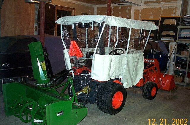

GEJLP,
If you only have X $$ to spent on an attachment, I would then get the FEL, best wheel barrel you can buy!
BUT if you have the $$ get both! I have a FEL and it works OK for snow removal, BUT the 3pt snow blower works a lot better. I have a Puma 54" unit, 3 passes and the driveway is done. With the 48" FEL many more passes are required to clean the driveway. The FEL is good for cleaning the end of the driveway after the town plow has gone by and leaves a mountain of snow at the end. A 3 pt snowblower is about $1000, if it is a front mounted type add another $2000 for the BX 2200. The FEL was $2200, so for about $3200 you can get a FEL and snowblower for the cost of just the front mounted snowblower.
If you want as much seat time as you can get, and like the cold, then get a FEL. Oh yea do not forget some sort of a cab to keep the snow off of you if you use a snowblower. I used a golf cart cover for $100, you can also go with a $1500-2500 hard sided unit by Curtis if you have the extra $$$ to spend.
Here is my snow removal tool.
Regards
Tom
