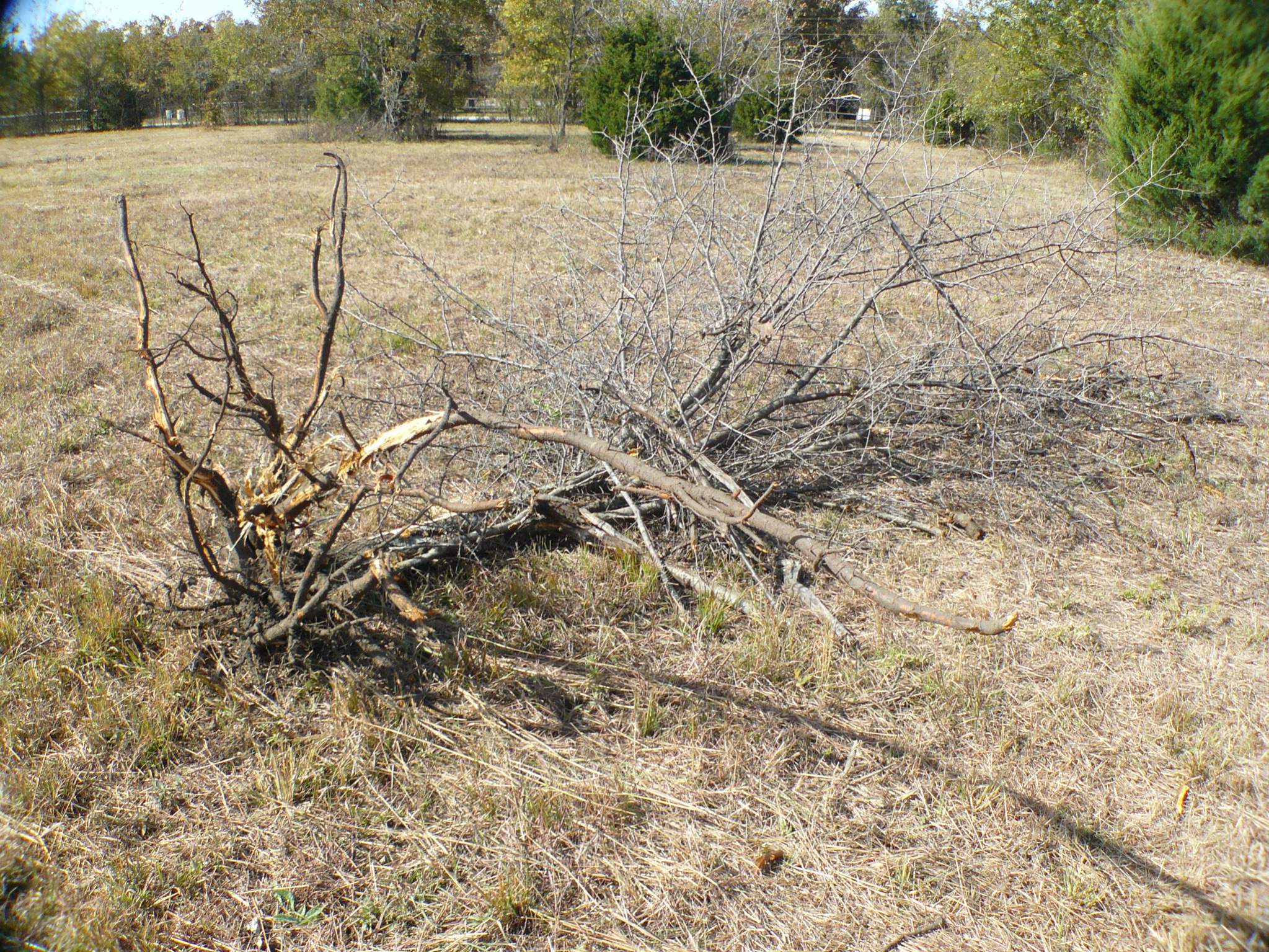

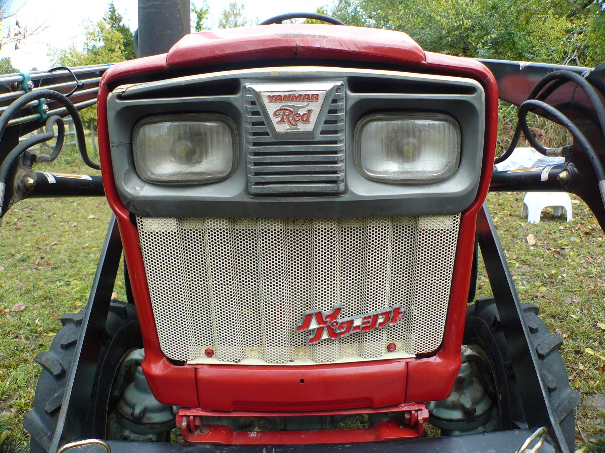

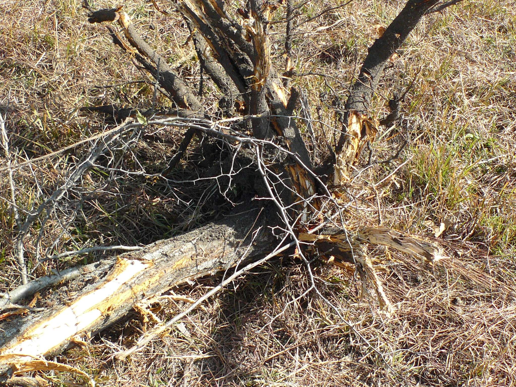

some pics

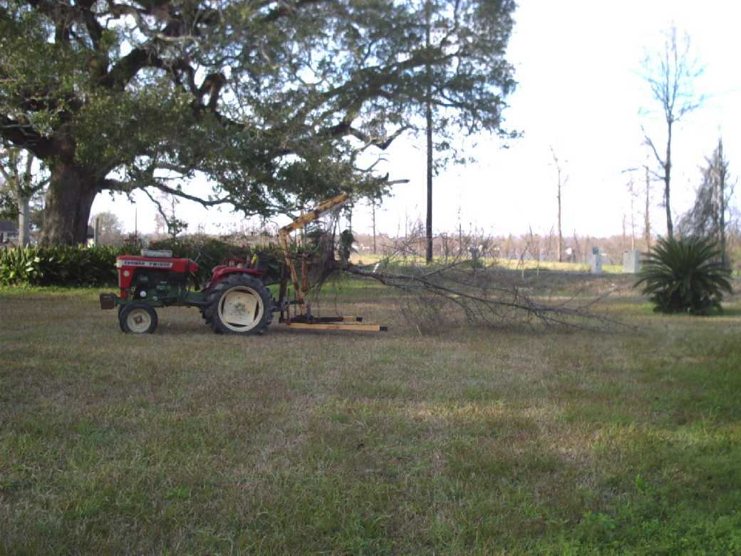

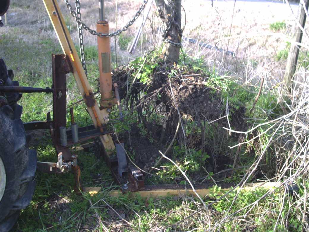

a few pix of Field Crane uprooting a tree

Yes! thats the lever I was thinking of! And the same principle mike was talking about. I couldn't find the follow up post and was wondering how it was too be used. At first I had some screwy thoughts on how to use it. After seeing your pics I think I understand. My thoughts would have defeated the purpose of the lever & just put me back to needing brute force and weight to pull the tree. If I am following the principles involved correctly; the swing of the lever is what does the work? & the height of the lever determines the amount of lift?
The crane looks good. nice work! and I can see why u prefer it. For me, since I have a fel, I think the lever would help me accomplish the job with less cost and fabrication. I can picture digging out around the tree with the fel and pulling it with the lever. Or the other way around. I will just have to make one and give it a shot. Did u have any problems with the frt of the tractor lifting up.
