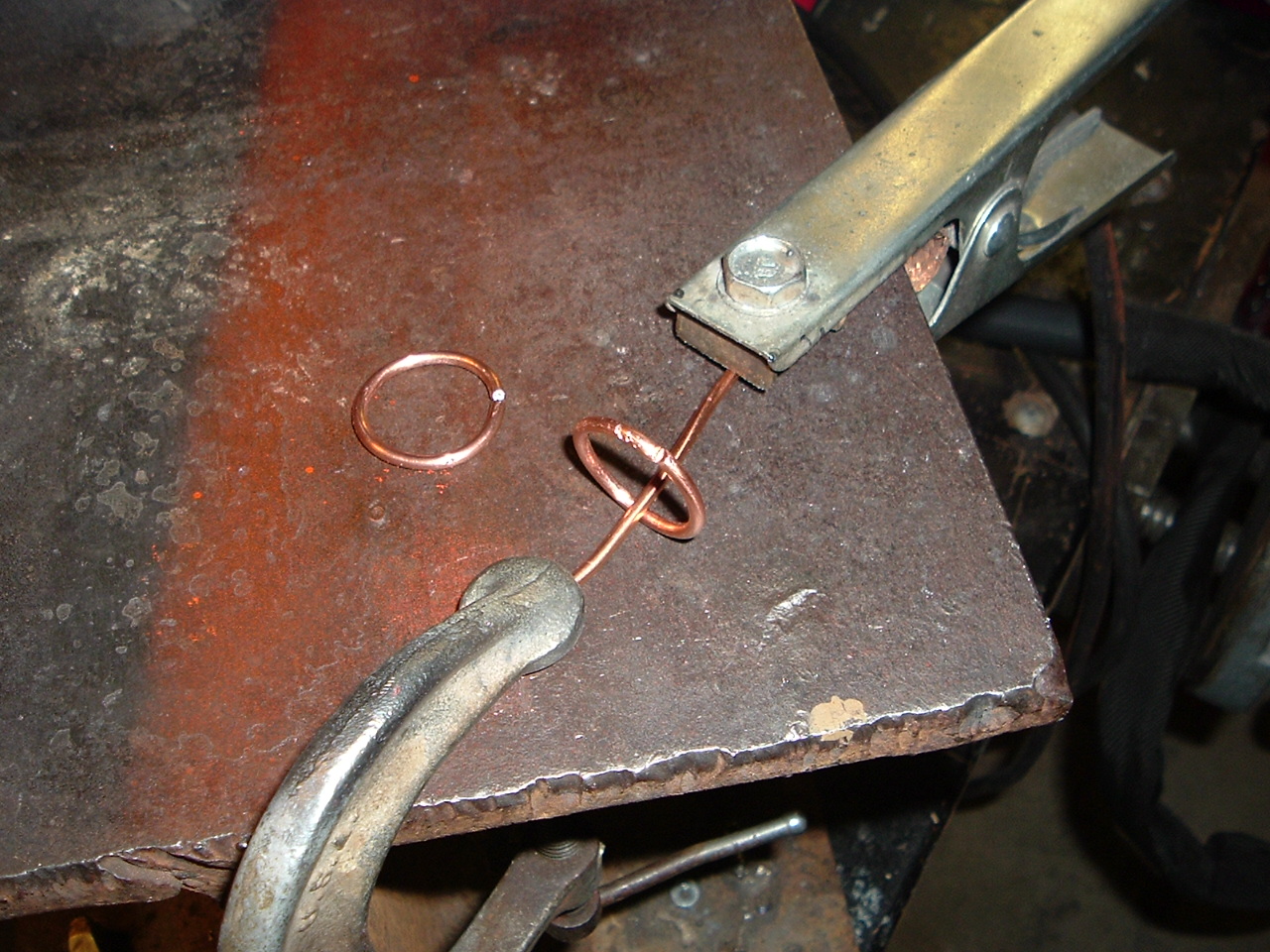

If I can do it you can do it. I use scratch start TIG for all those little things that are too small or too thing to stick weld very well. Also things like copper and brass can be Tigged. Is there a learning curve? Sure, but there is a learning curve with everything, and that is part of the fun. I can't do aluminum, but I very rarely ever need to do aluminum. And my simple cheap setup sure works for everything else. I just added a cheap 17V TIG torch to my existing PA160 DC stick welder, bought a $25 regulator and bought a bottle of argon and started to learn to TIG.
Here are some copper crush washers I TIG up from No. 10 house wire.

THAT is impressive, it's hard to tell where the joint is. Good idea to make your own up though. How many amps to do those? I'd probably have little globs of copper there instead of rings.

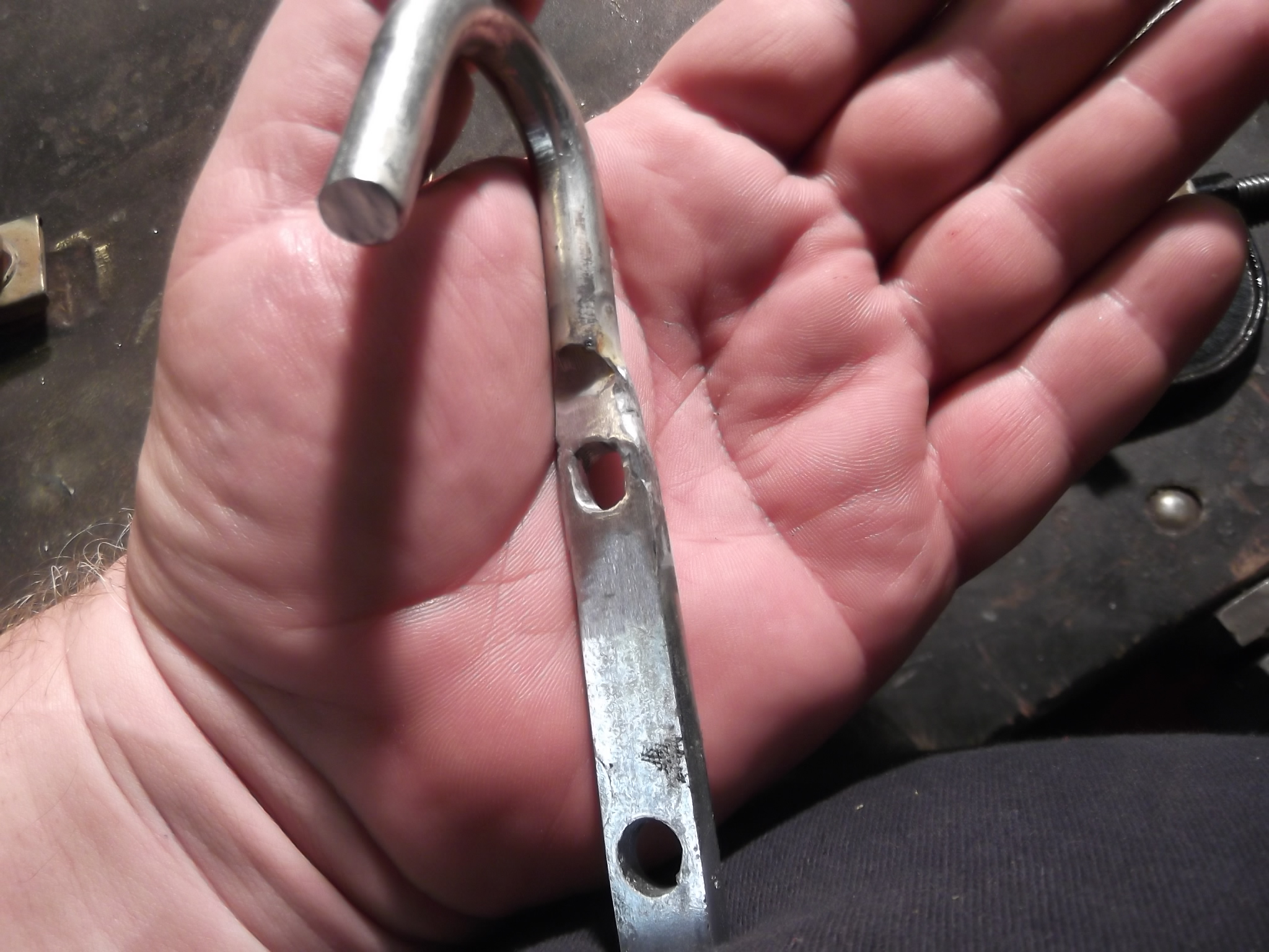

If I remember correctly it was about 25 amps. It is difficult on copper as it conducts well, and you make "globs" real quick.:)
Here is a little hook I foolishly broke off and wanted to repair with TIG.

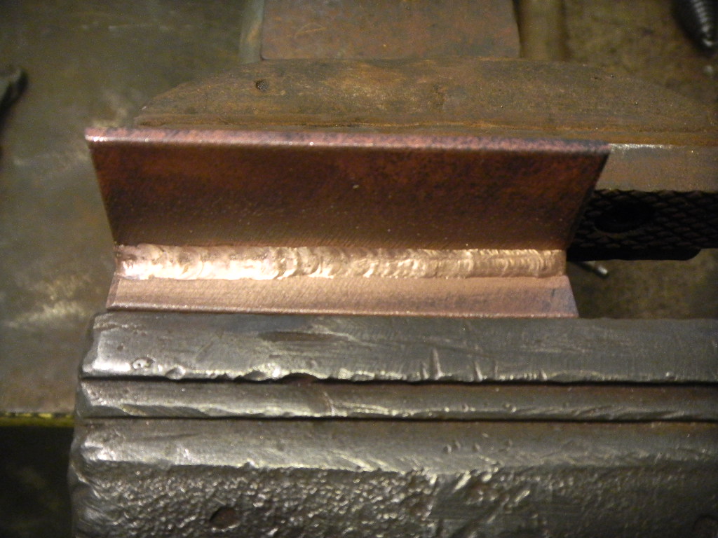

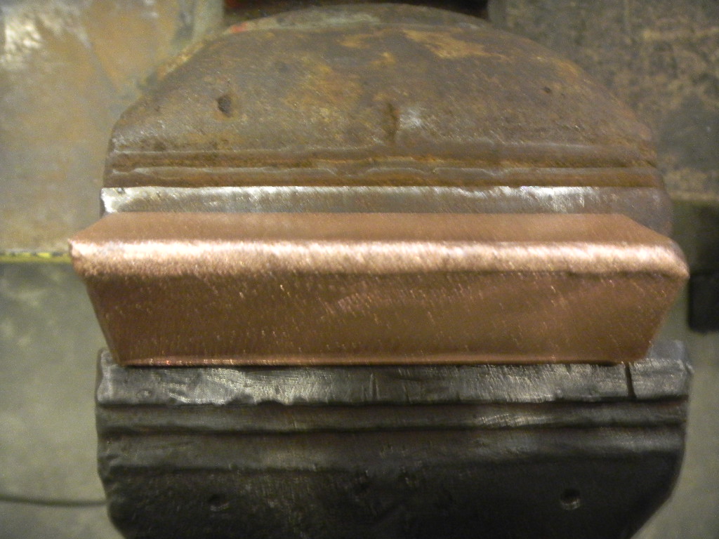

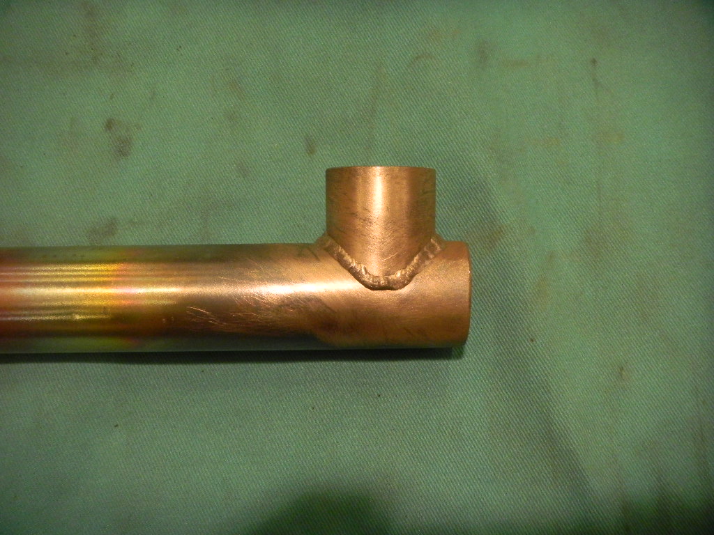

   / How hard is TIG to learn #10
Tig welding copper takes some real horse power. Copper is a worse heat sink than aluminum.
