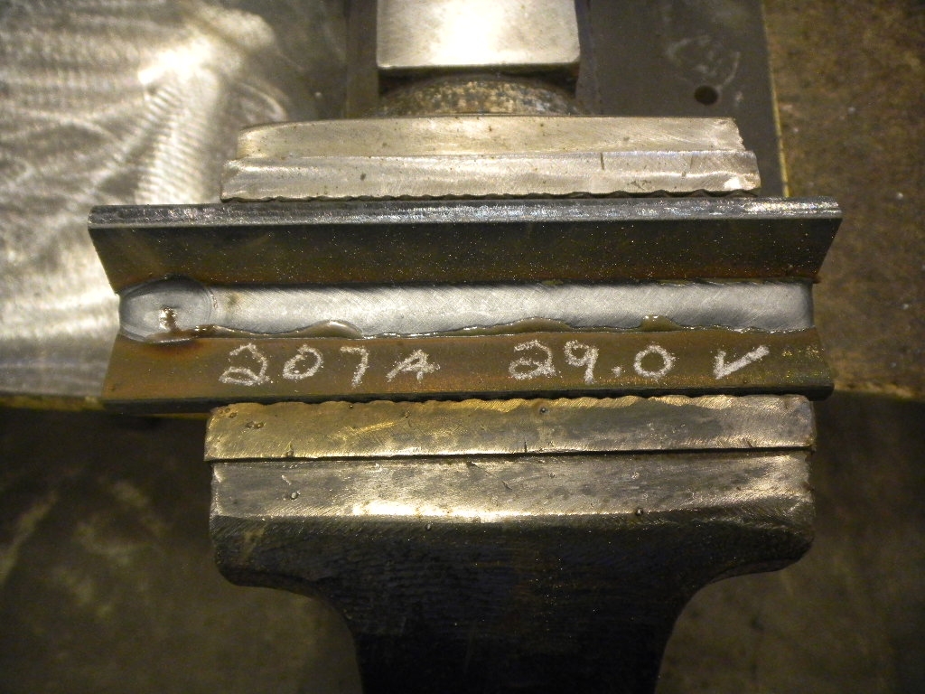

Tig welding copper takes some real horse power. Copper is a worse heat sink than aluminum.

Once the copper gets heated up, you have to start backing off the power. Another reason for a foot pedal. Same with Tig welding aluminum.
That there is dang near art work. Man is that pretty!:thumbsup:

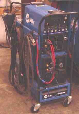

Oh it's not me:eek:! My Miller Dynasty 300 gets all the credit. I just turn it on, and get welds like that!

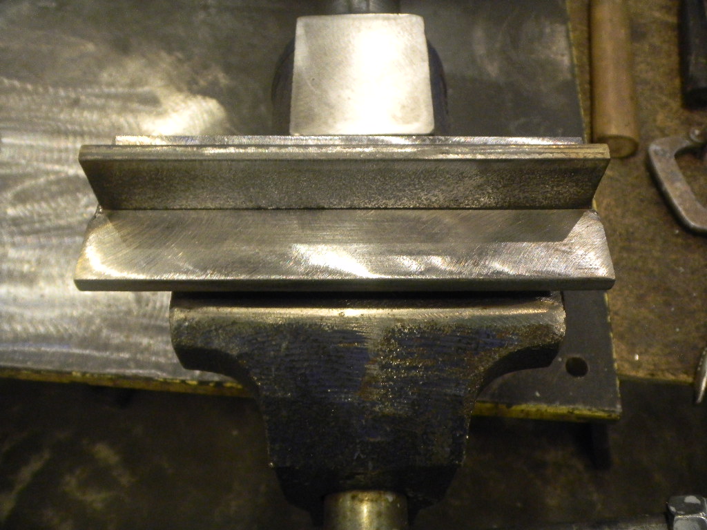

Geeez you guys do nice work. Very nice.
but I cheat every chance I get. I use rotating fixtures, clamps, flat positioning, anything to give myself an edge.:eek: That and I only post success's. :)
