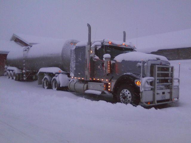

FWIW- I go from farm to farm picking up milk with a tanker..... milk trk.jpg

Creamer, an impressive looking truck, especially in the snow.
