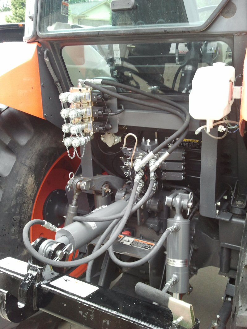

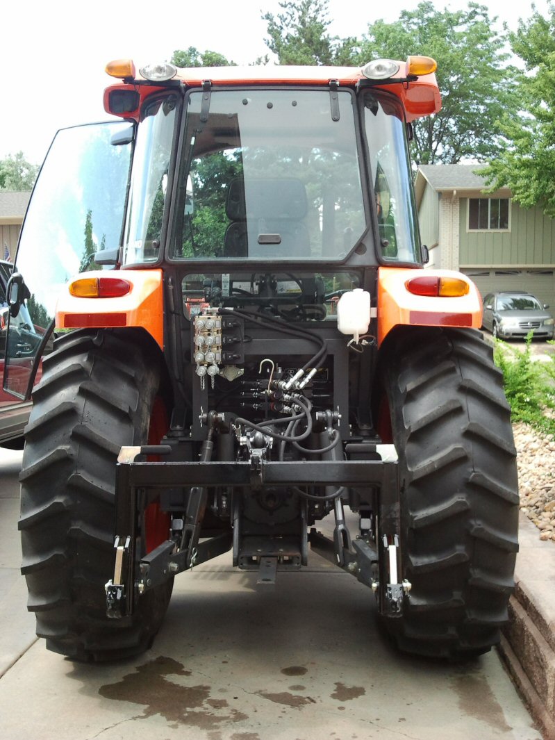

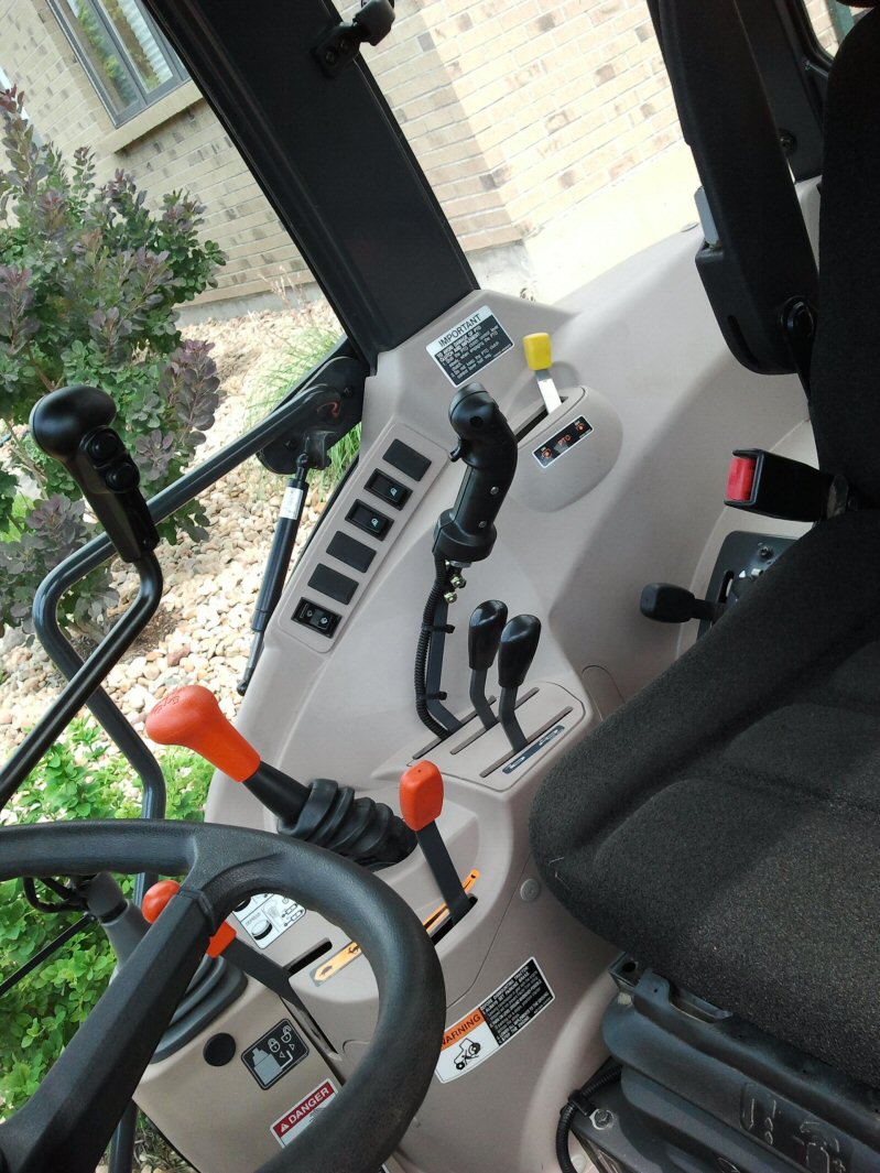

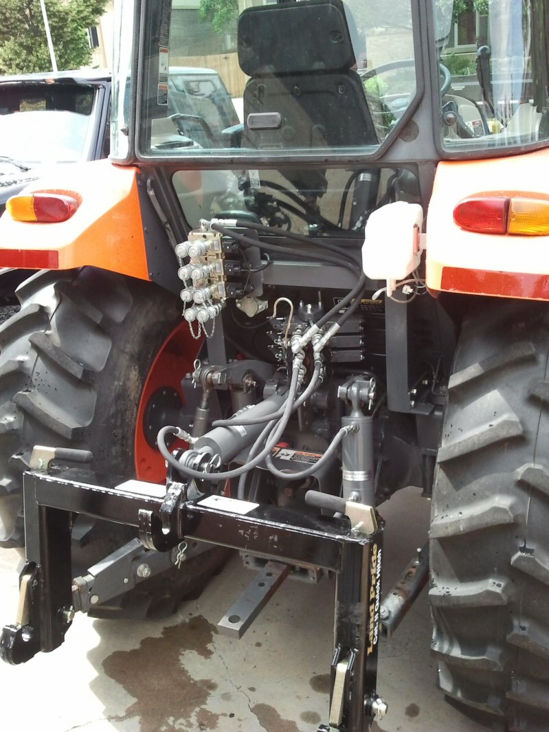

Electric diverters are no problem other that deciding where to mount them.:eek: Here are some pictures of a Kubota M7040 that had the 3 OEM valves, but this guy needed 6 sets, 2 for his top & tilt and 4 for his rear blade with gauge wheels. He has a nice control grip, could have been mounted a bit differently, but he was happy with it how it is. All 3 of the diverters are controlled through the one manual valve. He used that lever for all of his blade functions and the other 2 for his top & tilt set. :cool:

You use the outlets from your existing set of remotes. This feeds the diverters, see the 2 hoses going from his top set of outlets over to the bank of diverters? The switches are typically momentary switches. You push the button in the control grip and move the lever. The actual control is your existing SCV, all you are doing with the electric diverter-s is diverting that control to a different location.
I think that you are either thinking that there is a constant flow through the diverters which there is not or you are thinking about a closed center hydraulic system which you do not have. You do not have your SCV control lever kept open. You use the lever to control the flow just as you would or do now. You decide what hydraulic gets the control by activating the switch of choice. In the example, there are 2 thumb button switches and a single trigger switch. So he has separate control through the diverters for 3 separate hydraulics and a 4th set is the OEM set and is used just as if there were no diverters at all, simply move the lever to actuate the hydraulic connected to the default set of outlets. You have full feathering capability with this type of system where as with an electric valve with contant flow you have the valve either fully open or closed, nothing in between.
