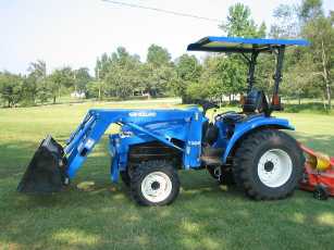

I have a TC33D with fel and never take it off. I have the R4 tires on it and have no troubles on the soil here. One thing is to not mow with the FWD on. It bites in somewhat if your turning short. Another thing is to make longer turns if mowing with a tractor. I would guess the weight close the 3 with mower and loader. The mower itself is 625 lbs. I mow about 10 acres of yard with this.
