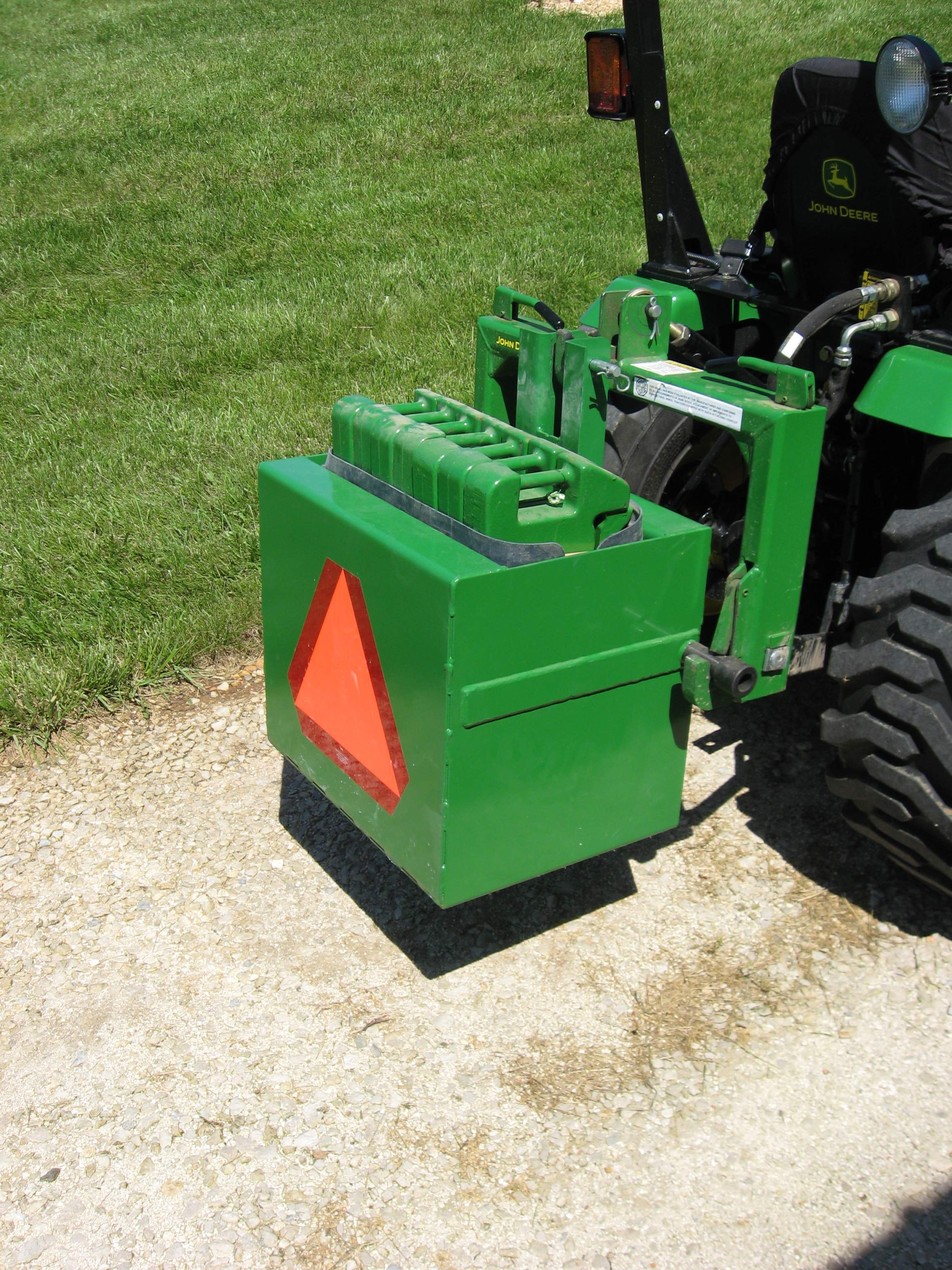

   / How heavy is your ballast box? #14
Mine is 809 lbs, of which 336 lbs is (8) removable cast iron weights (I added one since the picture was taken). The non-removable part is a combination of portland cement and old quick-crete that I had sitting around the shop.
This is for a JD 2520 with max lift capacity of around 1,000 lbs (including the bucket or forks). It sits on a wood furniture dolly with cast iron wheels when not on the tractor.
