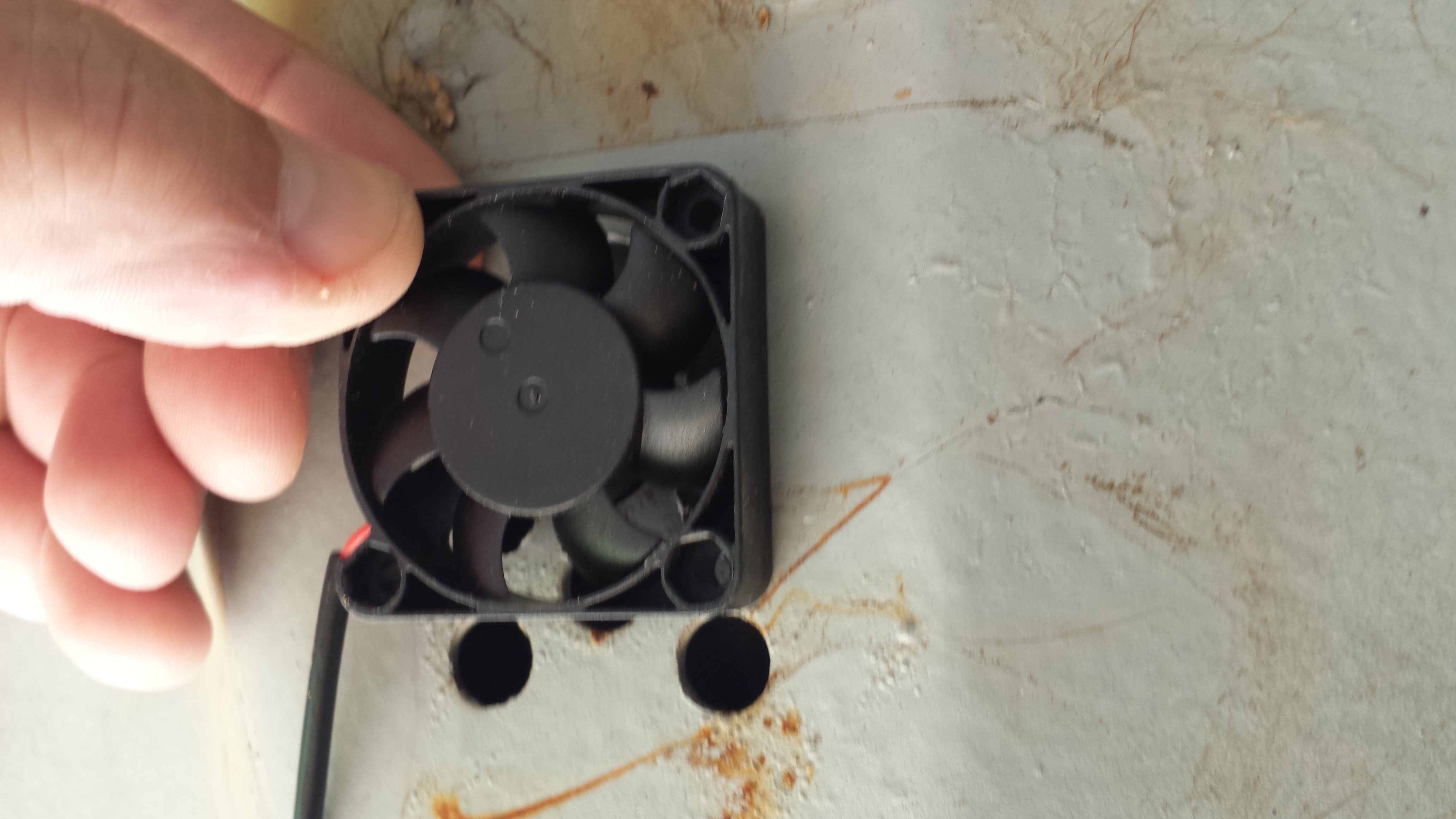

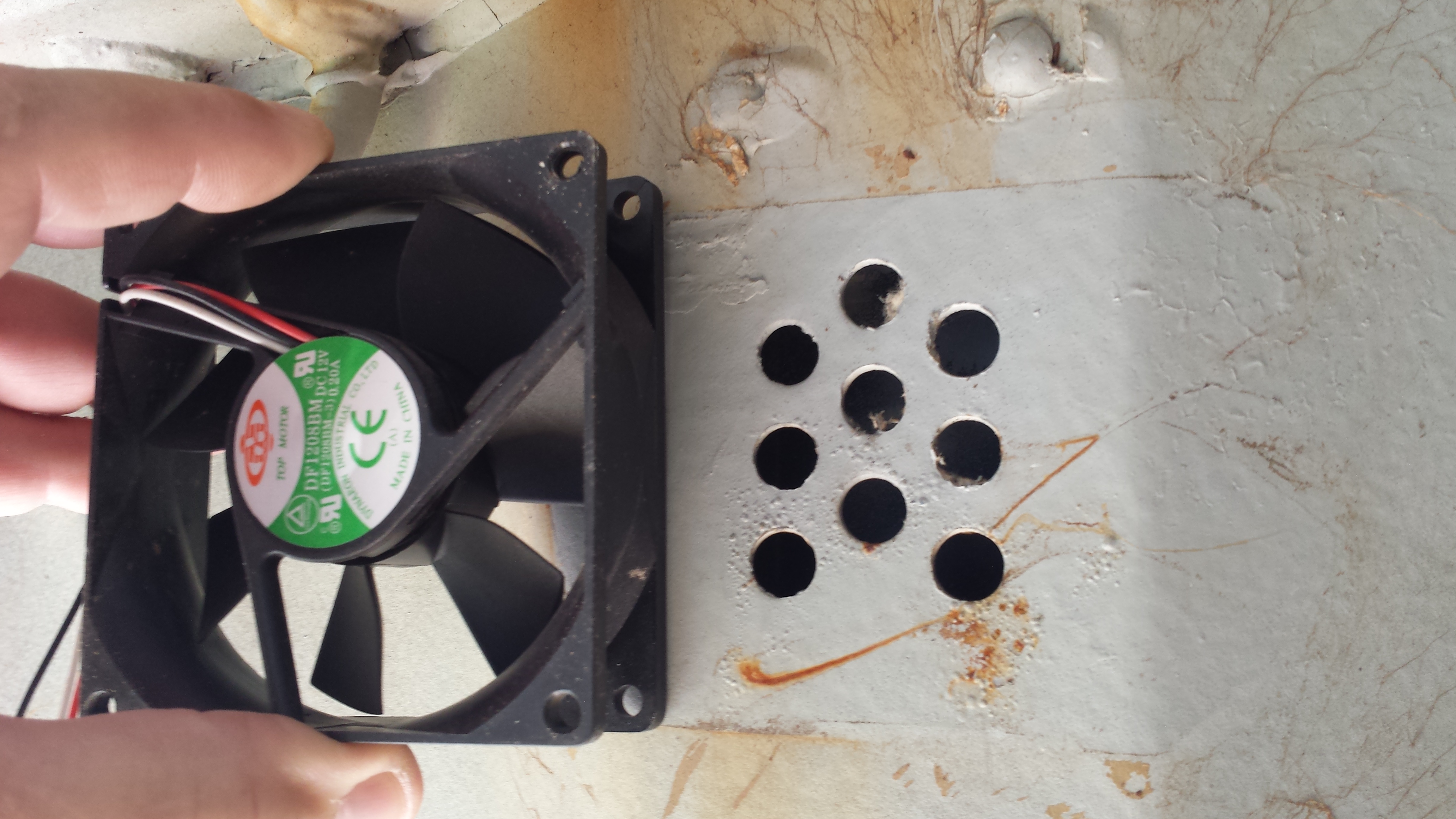

I'm tinkering with a couple mini fans I bought and some small surplus solar panels. I went over yesterday but needed to start on rebuilding a loader cylinder on my backhoe.
those move minuscule amount of air so may also try this at a later date.
I also have some white paint purchased for the whole container.
