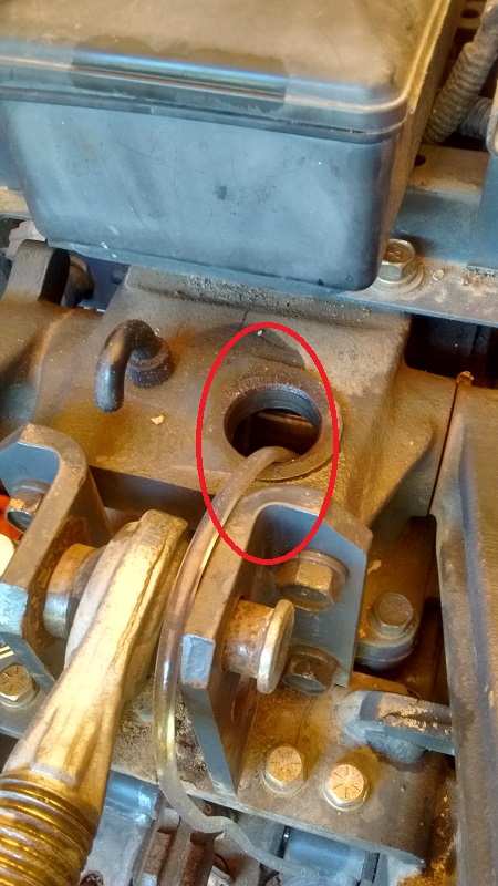

Pray tell, how do you get a sample of HST oil without making a terrible mess. <snip>
I admit it might be a terrible, difficult, messy project for some.
I worked the tractor (B7610) for a while to ensure warm hydro fluid.
I turned it off and lifted the seat.
I pulled out the fill plug above the three point.
I stuck a CLEAR aquarium air tube down inside and siphoned out the required amount.
attachment.php
Use a clear tube so you can see it.
Get the fluid warm if not hot so it flows quicker
Wipe off around the plug before pulling it.
The messiest part was the two or three drops of fluid out of the tube after I was done. But I had a full roll of paper towels handy.
