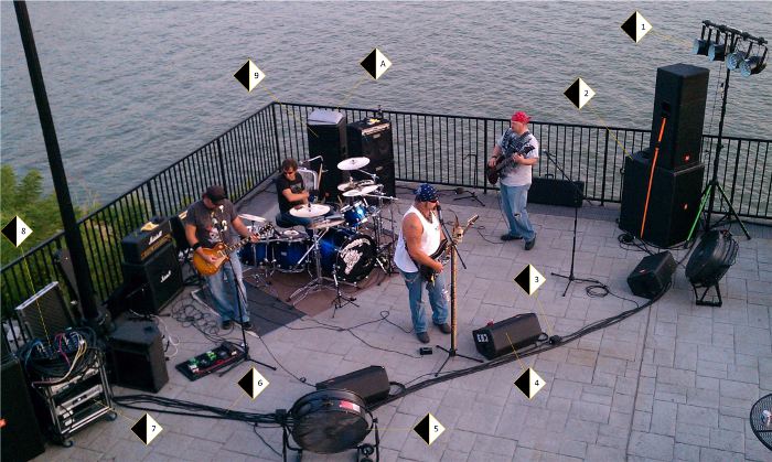

Nowhere here do I see any inkling of just HOW MUCH anybody, especially OP, drives in or actually uses 4WD!!!
I thought I posted this, but maybe I didn't. I work outside a lot during summer and sometimes there is pavement all the way to the stage, sometimes there isn't (at least once a week.) When there isn't I have plenty of equipment that is not meant to be pushed across grass, so I really need to be able to park my trailer as close as possible to where that equipment is being setup, otherwise it will be manual labor pushing heavy things on hard casters across wet grass, and that is really hard to do!
I uploaded a picture of some of it (there's way more not in the picture.) If you click it you see that #7, a case on casters full of amplifiers. That case weighs 300# and it is basically impossible to push it across grass without two guys. Those large subwoofers are on similar casters and weigh about 170#. Plus carrying all those small items a few dozen more feet, it doesn't sound like a lot of work, but try doing it a few times a week for a whole summer, and you too would appreciate the utility of 4WD allowing you to park your truck as close as possible! :)
I use my 4WD for real work on a routine basis. If you can push a 4000# trailer up a wet, grassy hill in reverse without doing any damage to the customer's grass and without using 4WD, you must have a better truck than me or more skill on the pedals. 4WD saves me time and money!
