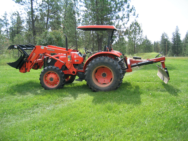

I have a Land Pride 1560 grapple on my FEL, Rim Guard in the rear tires, Rhino 950 - 8 foot rear blade on the 3-point. Configured this way - my M6040 weighs 10,100#. That's +/- 20#. The accuracy of the ADM grain scales in Cheney.
