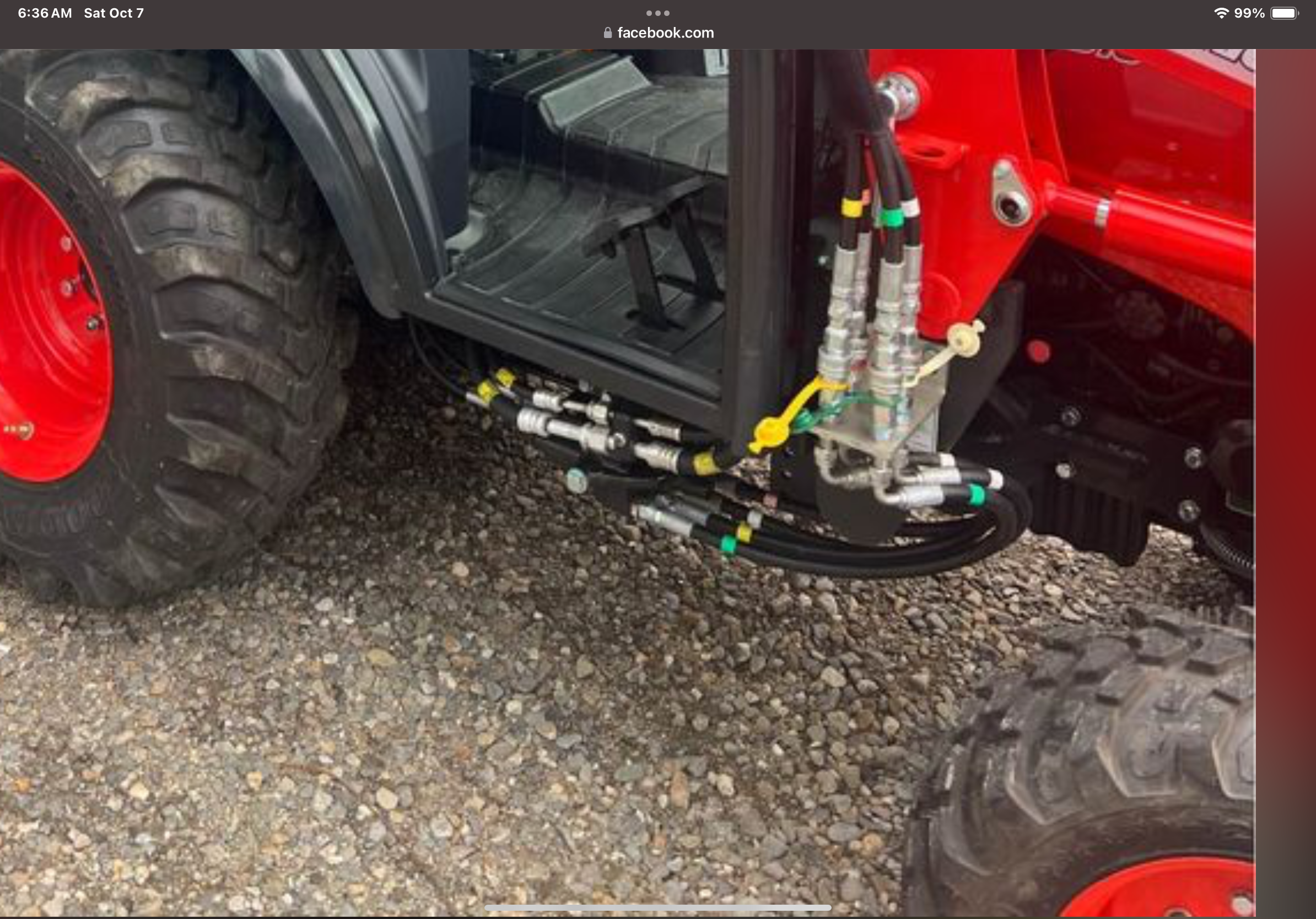

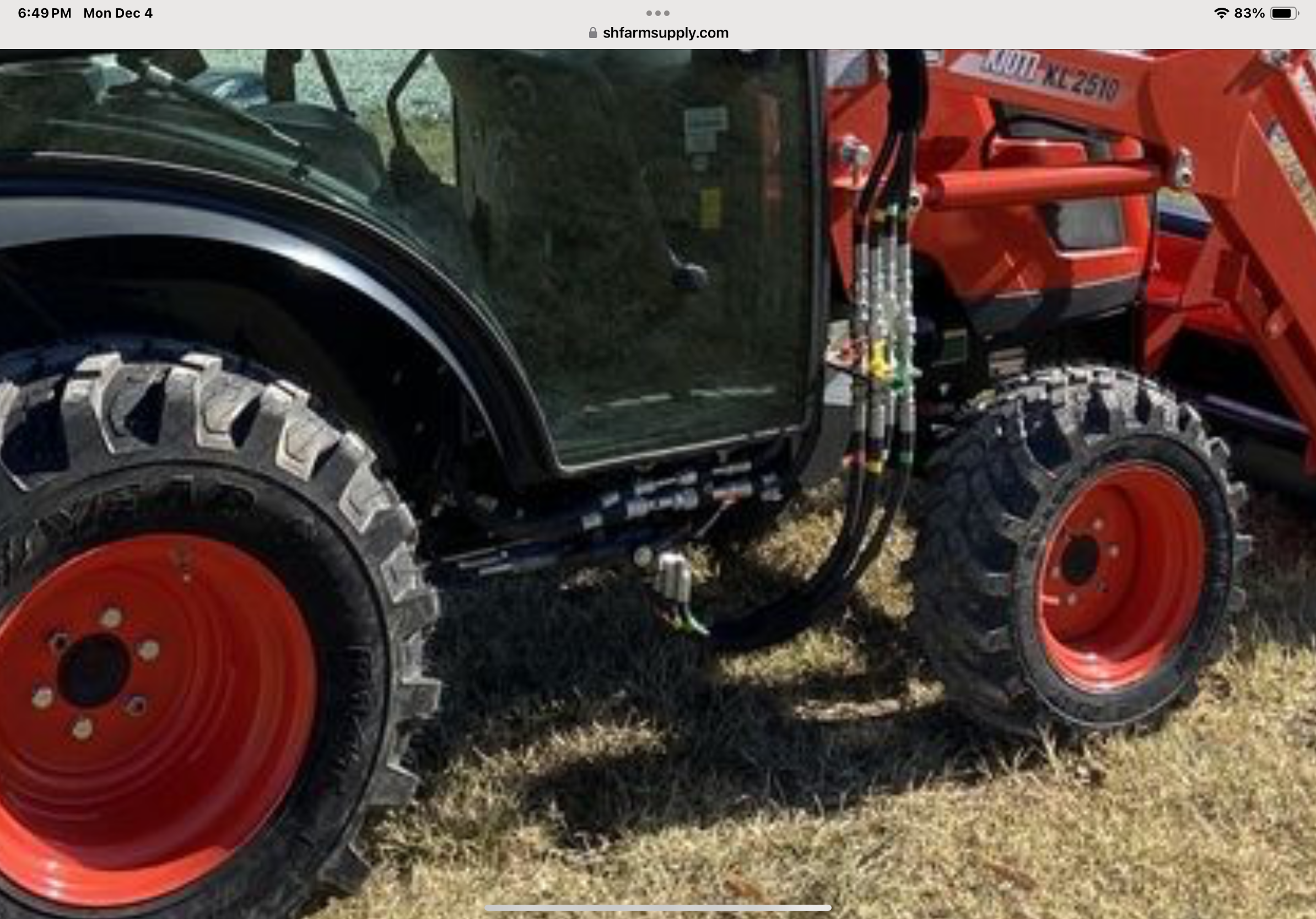

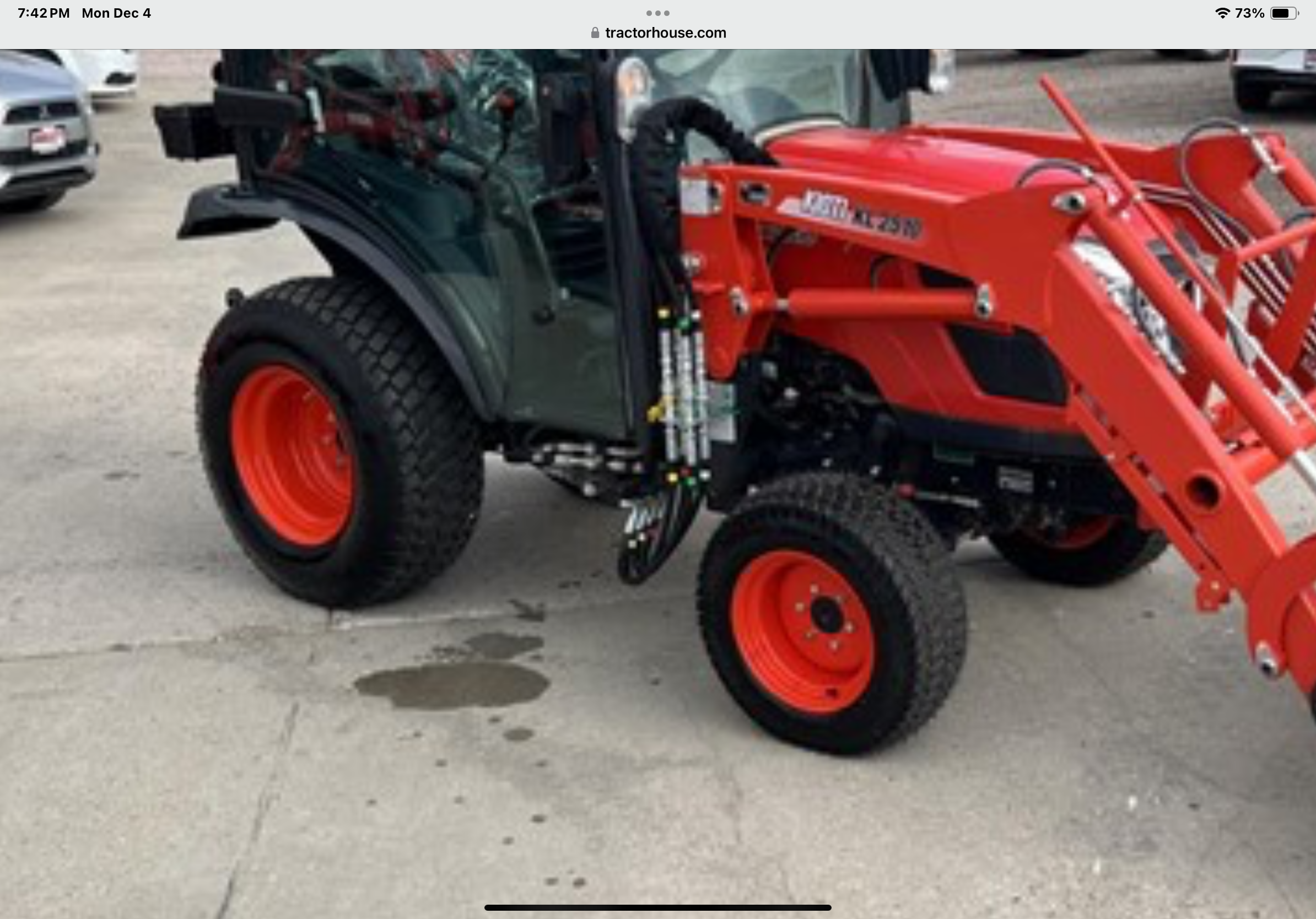

Seen many pics of loader hoses on CX cab models with the hoses hanging way down and near front wheel. In fact that was how mine were put before delivery. I told salesman that it doesn't look right and very prone to damage. So I suggested route looking at hoses and tech thought I had two heads and said it doesn't go that way. I said can we try as I don't like the one on it. Well guess what, worked perfect and the hoses are much higher and further from front tire. So here are a few pics of the low ones, and last Pic is the way mine is done.

Look like your "two heads" are better than dealers IMHO
