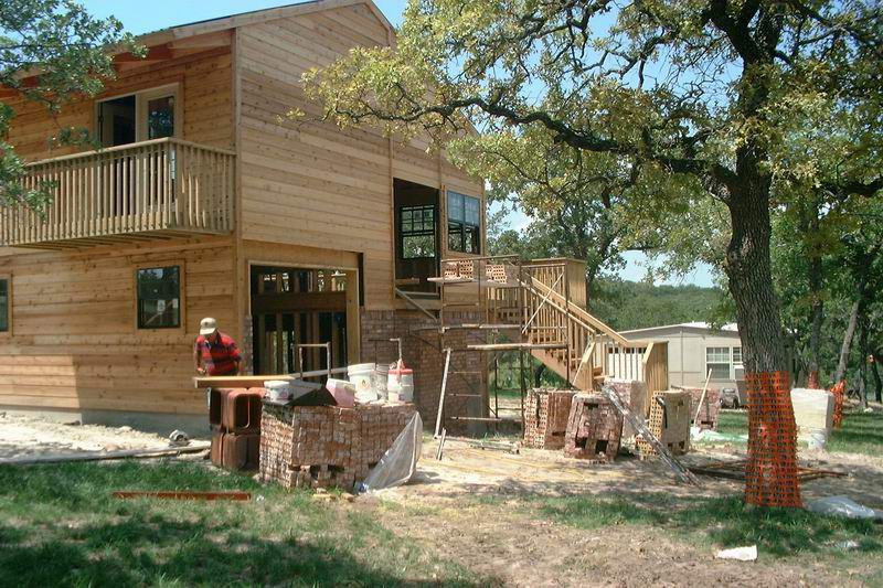

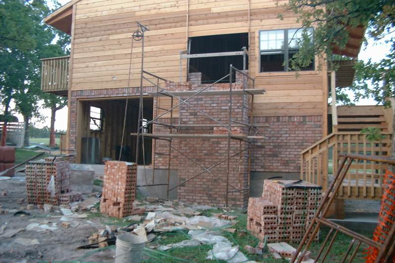

JB, you can rub it in, but you'll have to stand behind me in line. I've been kickin' my butt continually since I built this house for not incorporating another flue into the fireplace casement. As a matter of fact, the casement is not hollow. The builder and masons ordered "filler" brick to lay inside the casement all the way to the top. Essentially, this fireplace is solid brick from the base to the top, but I don't think all the filler brick were mortared in as the outside brick and the firebrick. Some mortar was used for stability, but essentially the inside brick are just sitting in there with little to hold them in place.

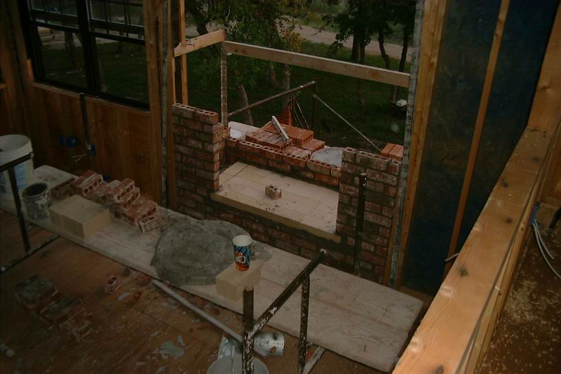

I should have taken more pictures at the time, but here are a couple more. As you can see, there is only about 4" on each side of the firebox and none behind the firebox. Also in the outside picture (2nd one), the stack of brick in the middle are not the same as the casement brick. They are cheap brick used to fill in the middle of the fireplace stack and around the tile flue. In the last photo, you can see the huge tile used for the stack. If I had asked for it, we probably could easily have made the fireplace a bit wider and put in a second flue or used smaller tile and allowed for two flues. Hindsight is so wonderful.:rolleyes:
You know your house better than anyone, but that's not normally how it's done. Typically there would just be a single wythe going up one or both sides of the flue to stabilize, those bricks would be mortared, to fill that whole core with dry laid masonry units would/could collapse the throat at the top of the FP under the weight. When the bricks are mortared in they transfer the weight to the foundation via the veneer.
Do you remember how they did the floor of the firebox, could of been done a couple different ways, usually double course walls up to the bottom of the fireplace and a bed of cement on a steel pan resting on the inner course. or a block or brick frame work coming all the way up under the floor of the fire box.
Either way there should be plenty of straight shot in most of that core, except at the fireplace, though that first pic you show here has some promise, you can see there is nothing at the back but at the inside corner where the floor of the fireplace is the narrowest, shows some space there. Hard to tell how much space, it's ok to ovalize stove pipe to a certain degree to fit a narrower space.
Anyway It might be doable but would require some intrusive and destructive inspection, which could be done from the outside or maybe the basement.
Your flues look large, hard to tell by pics but maybe 12x16 or 16x16?
Around here new FP usually has 12x12, 25 years or older and all are 8x12.

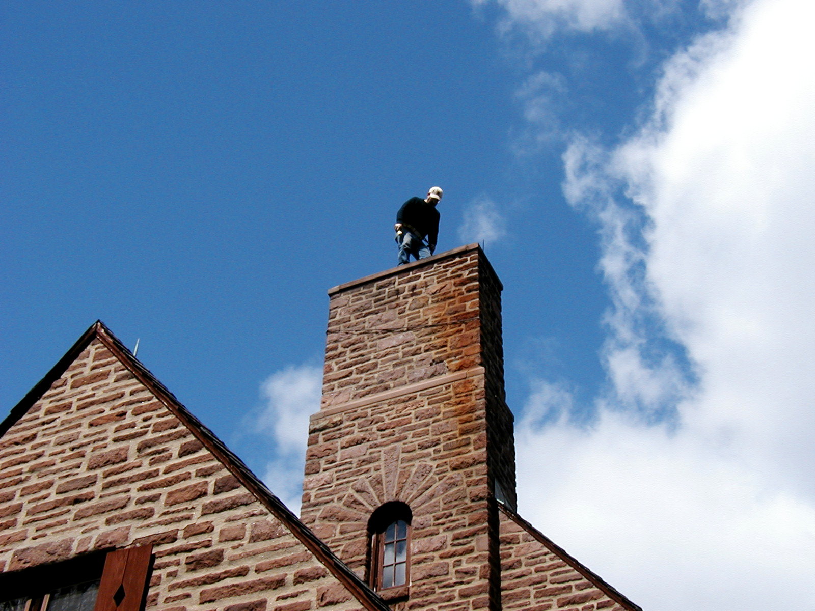

Just a couple of show off pictures of me on a huge house, I use to do alot of chimney repair, not as much anymore.
JB.
JB, one of the original pictures I posted may have a clue. Above the fireplace in that picture, you can see that the filler brick are indeed mortared in as you suggested. I was not there for the complete construction of the fireplace and only saw the beginning, middle, and end. I do remember seeing loose brick filling the middle below the firebox, but I may have been mistaken as to the mason's methods. They may have just put loose brick in and then applied mortar similar to a grout over the course of brick and then added a second just to save time. There's no need to have neat brick laying in the middle of the fireplace. They may have just opted for the quickest method. I do remember that the contractor had to go and get an extra two stacks of filler brick because there were not enough to fill the void.
Also, I believe there is no metal pan below the firebrick. I don't remember seeing one, but I do remember some type of special mortar for the firebrick and they may have used something similar to make a mortar "pan" below the firebrick and on top of the solid filler brick structure. Looking at the linked picture above, you can see that the side walls of the finished firebox are set in from the edges of the firebox floor seen in a previous picture. I believe the side walls are double thick firebrick laying on their edges. The top of the firebox's brick veneer sits on a steel angle iron similar to garage door openings in brick veneer houses. I just don't think there is any open void inside this fireplace structure except the smokebox and flue pipe. All the rest is solid brick and will not lend itself easily to modification.
