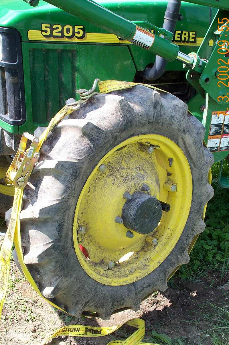

Here's how not to do it...
The attachment from tractor supply does not depress the valve plunger, as I thought it would. The drill pump could not build up any pressure. So I removed plunger from stem and went with the funnel idea. Of course this let all pressure out of tire. I had supported tractor so that tire was still on ground - deflating it dropped tractor 1/2 inch. This was enough to separate tire from rim, and I can't get air in. (Well, I can get it in but it comes right out.) I will try jacking up tractor this weekend and hope tire will seal back on rim.
But I am afraid I have a trip to the tire store coming up. And with a tire part filled with fluid. Any ideas are appreciated but I'm pretty much writing this off as a lesson of some sort.

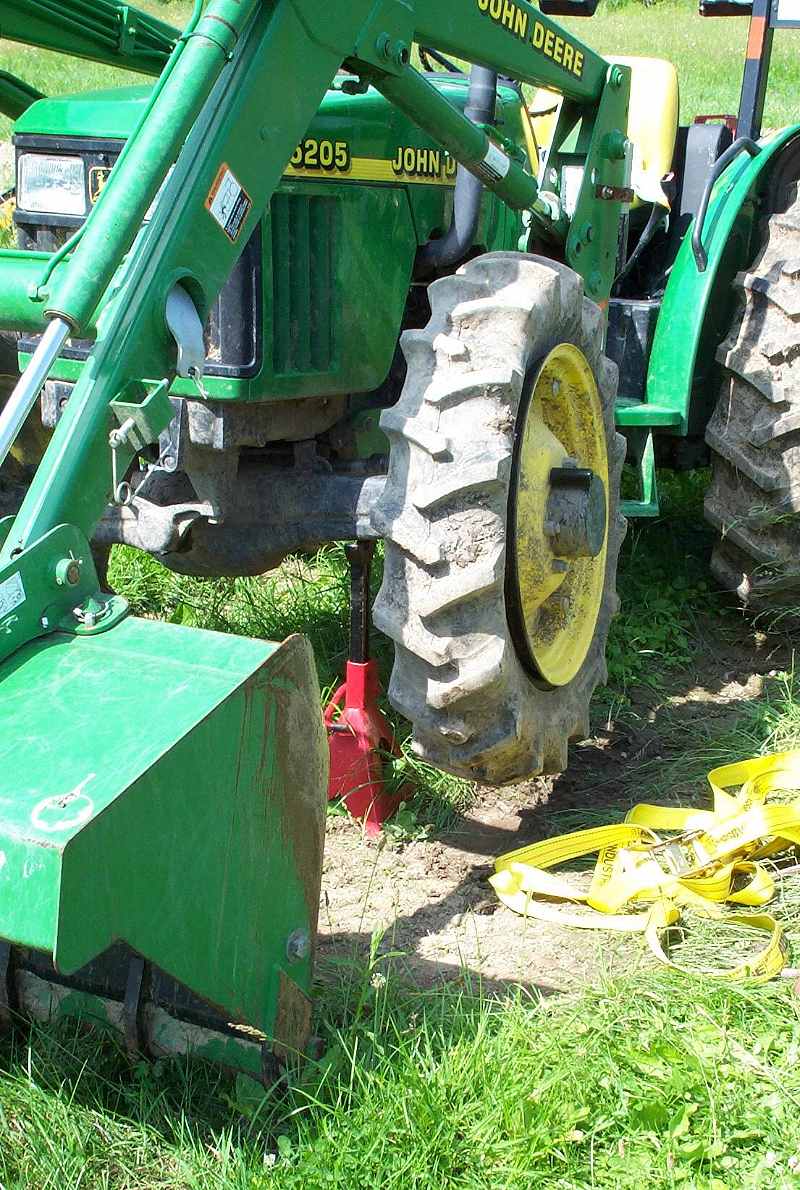

   / how many gallons per tire #14
To re-seat the bead, try jacking the tractor up enough to lift the tire clear of the floor. If the bead is only broken off on one side, there is a possibility that's all you'll have to do to air it up. However, if that doesn't do it, wrap something around the center of the tread that you can tighten. When you tighten a band of some type around the center of the tread that pulls it in toward the center and causes the bead to spread out and make contact. I've used a variety of "bands" to do that; everything from the inflatable ones that tire shops use to a come-a-long (winch pulley) to the ratcheting straps used to tie down loads on a trailer. Just remember to start loosening the band as the tire starts to take air. And it's really quite simple.
   / how many gallons per tire #15
<A target="_blank" HREF=http://www.tractorbynet.com/forumfiles/47-216263-SeatingtheBeadBeforeCloseup%3D800.jpg>I was ready to take my wheel off this summer when I lost the bead... (from a slow nagging leak)...</A>

   / how many gallons per tire #16
<A target="_blank" HREF=http://www.tractorbynet.com/forumfiles/47-216266-SeatingtheBeadofAg%27safter-800.jpg>But... this was my solution for seating the bead right on the tractor...</A>

Great idea. I have both the bands as shown and a chain and boomer. With flat profile of industrial tire it should be a cinch. (sorry). I wish I would of thought of this when I changed the tire on my old riding lawn mower. I must have put 4 hours work into it before taking it to a tire store. Thanks a bunch.
You saved me money, time, and a little embarassment, and people will think I'm so smart when they find out how I fixed it.
