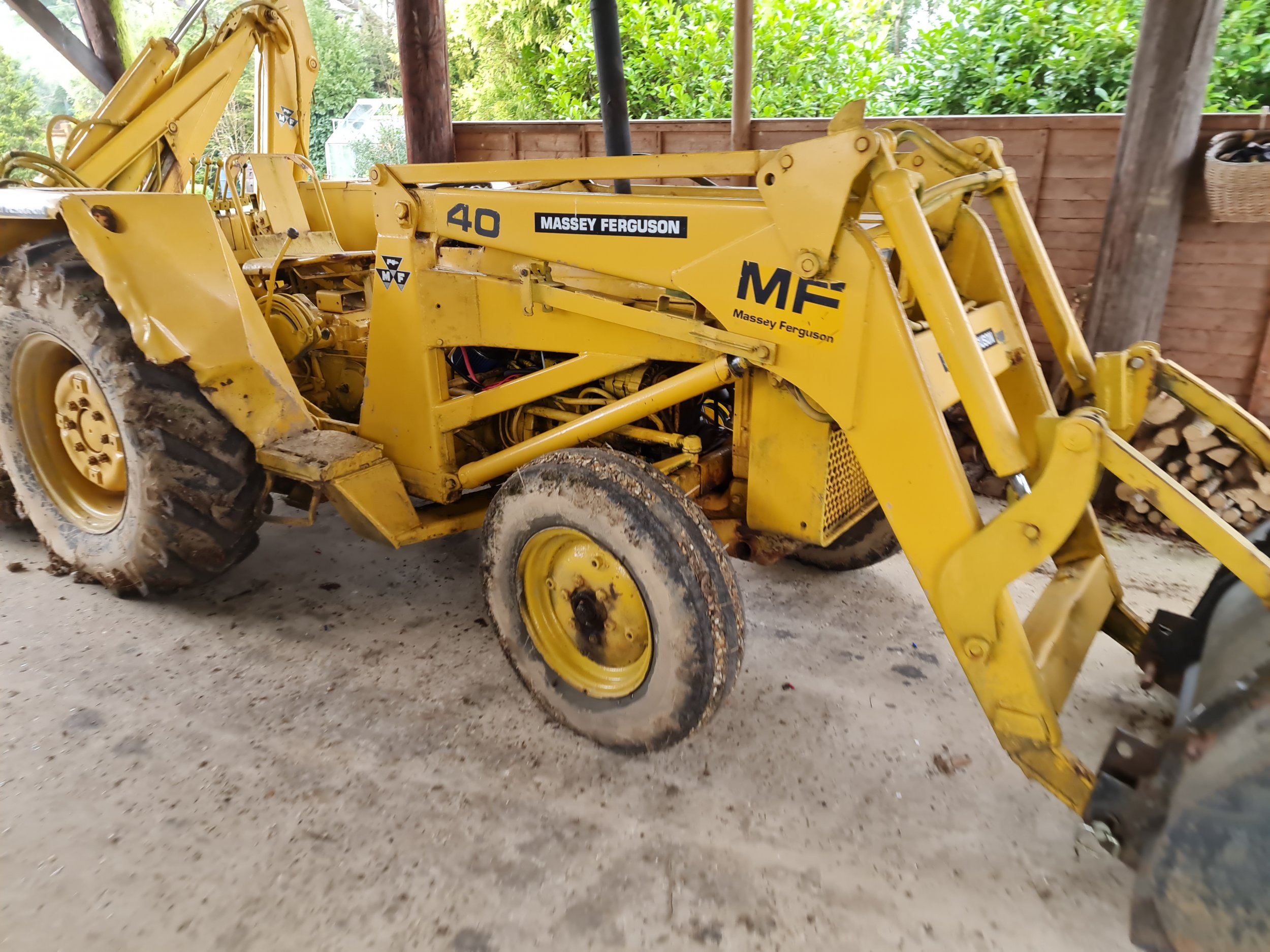

I've aquired this beast recently but don't know much about it. Mostly it's similar to my late M35x, which has M135 engine
It seems to only have 4 gears, ie 1 and 2, in high and low ranges - I am ssuming it should have more...?
The gearbox is the hydrostatic type with no clutch, so a forward and reverse pedal.

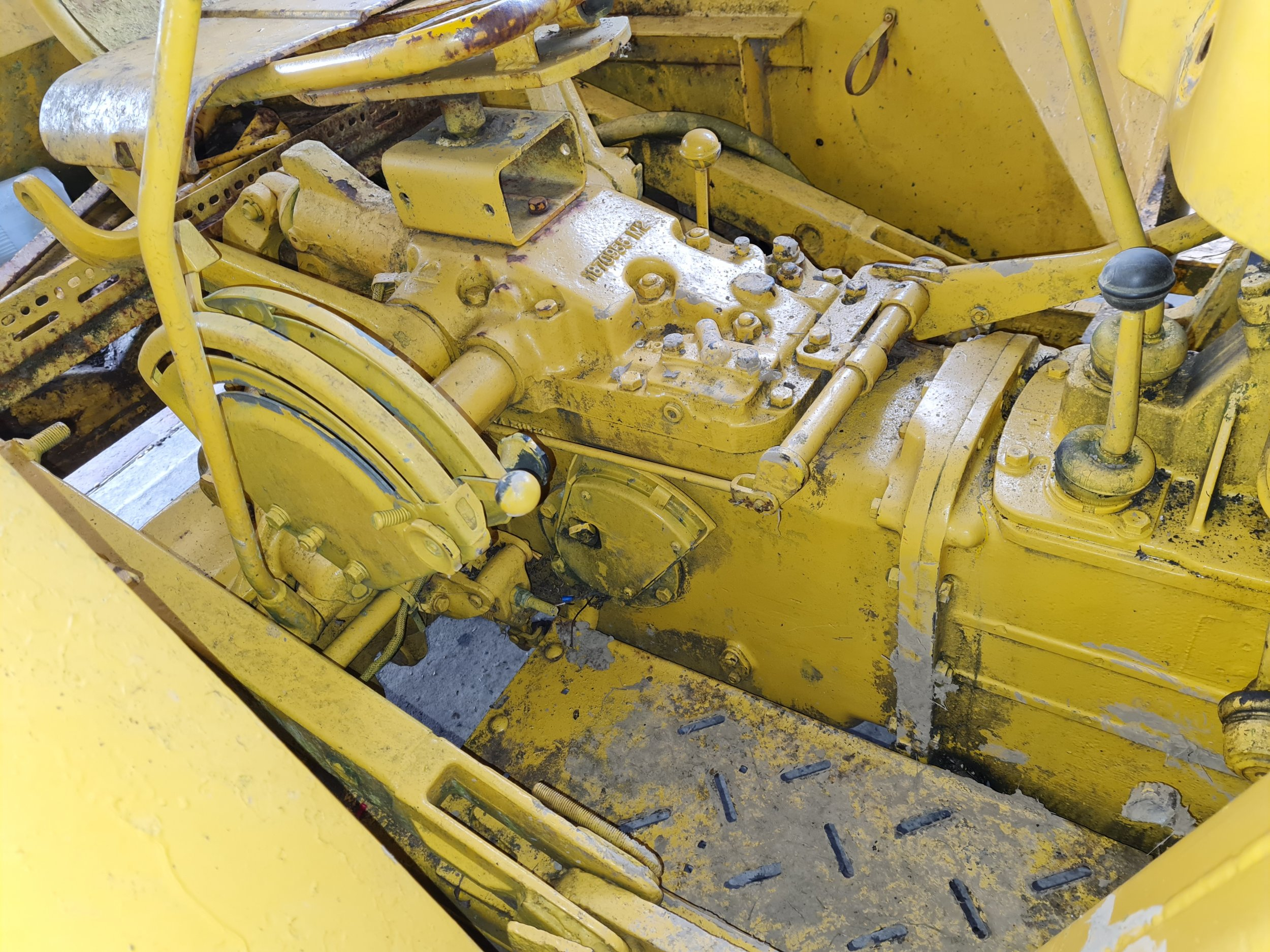

.Also - could anyone tell my what this lever does, the lever by the gearbox dip stick - dead centre of photo, under hand brake rod
Also - if anyone has had the interest to read this far, the power steering doesn't work, any ideas what to look for or check would be much appreciated

Does it change the flow rate of the hydraulics?

possibly - I'll give it a tweak next time I power it up...

Lever is for the 3pt response.
Power steering pump (if like the ag tractors) should be on right side of engine and have it's own fill port (separate oil system) Check oil level by removing fill cap.
