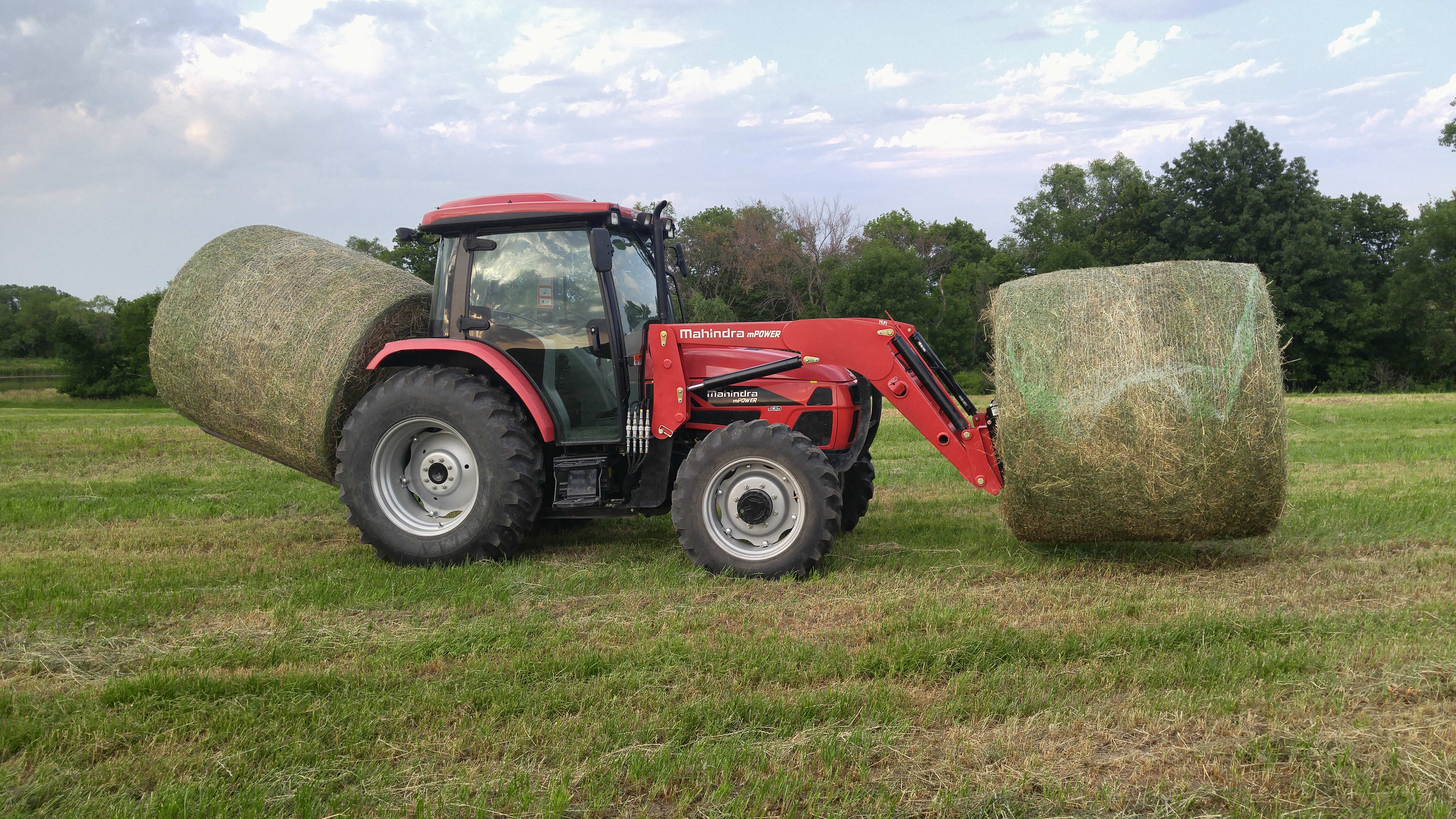

Dave, thanks for this post. Very interesting to me as I am now 12 months into my mPower 75P Tier IV with 125 hours on. I had the scavenger pump sensor issue at about 5 hours, replaced the sensor and good to go with that, and then 4 bolts were loose and 2 fell out on a front tire rim while discing last spring. Oh and the trying to get the hydraulic filter off at the 50 hr service WAS a b#$ch! Other than that love my mPower.0620161947b.jpge

Dave, thanks for this post. Very interesting to me as I am now 12 months into my mPower 75P Tier IV with 125 hours on. I had the scavenger pump sensor issue at about 5 hours, replaced the sensor and good to go with that, and then 4 bolts were loose and 2 fell out on a front tire rim while discing last spring. Oh and the trying to get the hydraulic filter off at the 50 hr service WAS a b#$ch! Other than that love my mPower.View attachment 491846e
My only gripe on the scavenging pump sensor issue is that it has been going on for 10 years. I guess it is a minor deal dollar wise for them to pay as they occasionally fail, but they really ought to install a high quality sensor. Even minor issues can cause a customer to wonder about quality and it diminishes the experience. On the lug bolts and rim bolts, it sure pays to retorque them after about 10 hours of usage. But I will say, these are pretty nice tractors. Heavy, good turning radius, strong loaders, etc.
