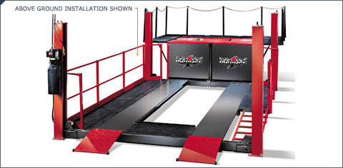

It must be a large dealership if they have their own dynamometer. Those puppies ain't cheap. Never heard of a dealership with one; that doesn't mean there aren't any. Usually they're used for research at the factory or for performance improvements at race shops. It has to be a chassis dyno (one you can drive on and off); an engine dyno requires the engine to be removed and does nothing for the rest of the machine. Typical dyno time runs about $85 an hour to use someone else's machine. To be effective in finding leaks and testing the equipment, it also requires someone to change gears and such, putting it through a normal operating sequence. Seems like a waste of time and money to me; that's what the 50 hour service is for.
They may know something I don't, or they may have some kind of roller or something they're calling a dyno.

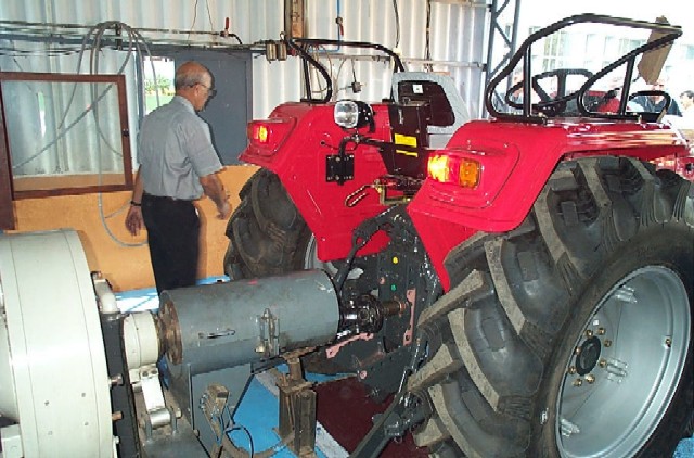

It used to be common for Ag dealers to run a tractor in on a dyno. That way they was sure that the rings would seat and that the initial break in was right. The dyno is PTO driven and most likely a made by M&W.

Yep, Don, you're thinking of the drive on type, and where tractors are concerned, I guess most of us think of the PTO dyno. I have no idea how many dealers have them, but have seen one (with a whole bunch of driveshafts and adapters) at a John Deere dealership.

Guess I don't know what a PTO dyno is. The dynos I'm familiar with are used for testing and comparing output from race cars. Attached is a picture; on a quick search, the cheapest one I found was $24,950. Not something most dealers would have.

So, I did a quick search for a PTO dyno, and came up with this picture of a Mahindra hooked up. Is this typical?
