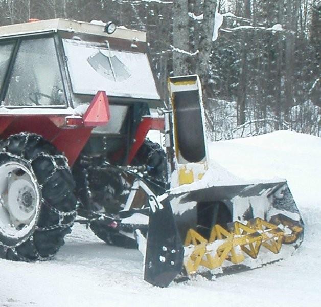

I have a Agri-Power 5000 (Zetor 5011) with 43 hp pto and a seven foot snowblower. Works fine under almost all conditions, but the lake effect snow around here is pretty light stuff. If the snow is too deep, you can take it in slices. You don't have to remove it all down to the ground in one shot.
