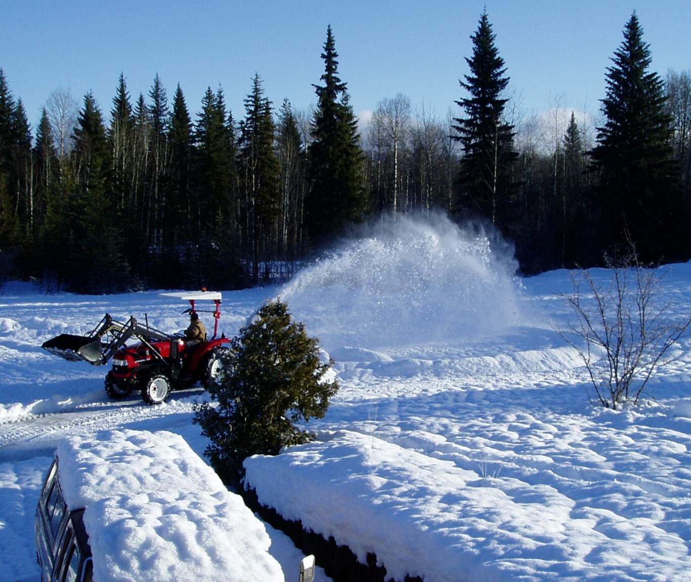

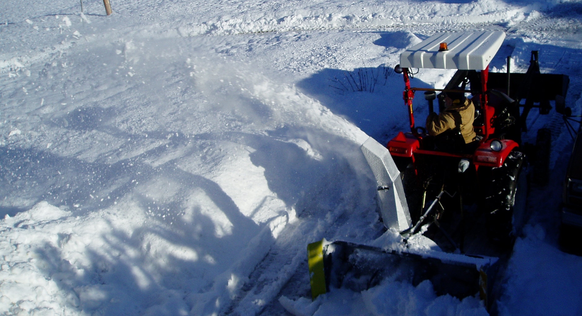

I too have a 55hp tractor which I use a 6ft (73") snowblower on. The rear wheels on my tractor are 74" outside to outside and end up rubbing the newly cut drift and making a mess. To get around that problem I have made and added wings on the blower - which help a lot. I regret not getting a 7ft blower for my needs
I am considering buying a 7ft blower (84") and selling the older 6ft blower.
I doubt you will have a problem with the 84" blower on a 55 hp tractor. If you bog the engine down, you need to go a bit slower or take a lighter cut of say twelve inches at a time - you don't have to do it all in one cut.. I am lucky as I have 8 reverse speeds which gives me a lot of choice.
