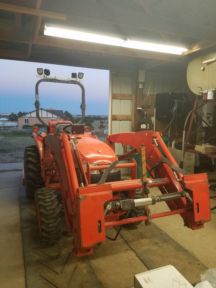

Could be some or all of the parts can be used on other QAs. In any case the parts diagram would be a good guide for fabrication.
   / How many times a day do you change the front attachment? #28

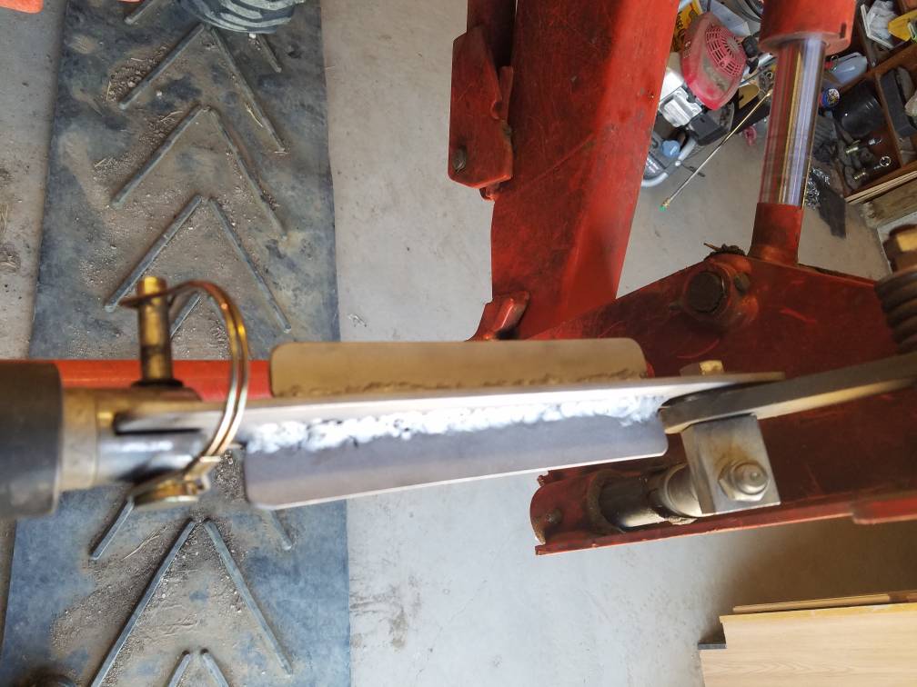

See my link a free posts back to my linear actuator based build. The OEM Kubota cylinder alone is over $800. I'll be into my new build on my L4060 about $350 or so using a random cylinder of appropriate stroke I found for $50 or so.
Really there isnt much to it. Cylinder or linear actuator & connect it to existing mount points with some longer bolts & bushings. Match the stroke length of you cylinder/actuator to the travel distance of the mount points. Then make a bracket to connect the cylinder to the bolts on the mount points.
I was using a 200lbs rated actuator if I recall, so despite not having the leverage of the manual handles the forces involved are still pretty low. I got the smallest hydraulic cylinder i could for my new build to minimize its strength & ability to break things if pins weren't aligned. I forget the size offhand, but 1 square inch of piston is 2,000-2,500lbs of force. Well beyond my previous 200lbs actuator. 20160910_192309.jpg20160821_143315.jpg

I made my own hydraulic operated QA from scratch several years ago. I have had a tool fall off but only because I forgot to cycle the cylinders to push the locking pins in. Otherwise 100% reliable and simple to use.
