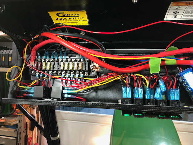

I just wired my refurbished curtis cab with LED lights and the factory cab lights, I used relays and switches as it would be done in the factory. I have used 10 amp fuses for any of the LED lights. I use 20 amp fuses on the wipers and original cab lights. The lights I have are SMD3030 chips emitting 6500K bright light and 3000K super yellow light, providing 120w and 12000lumen.
One thing I would think about is the new LEDs that offer not just the white but the amber light. My light bar that I had installed on the ROPS before the cab was so bright, no one could work in front or in the rear of the tractor without being blinded. I now replaced them with the multi mode LEDs that have Bright white, Amber, Bright white with Amber, White Flash, Amber Flash and Bright White/Amber Alternating Flash. I hooked up a momentary switch to the yellow wire on the lights and change them with a simple bump. The amber light is a nice bright soft yellow the illuminates and does not blind anyone great for working at night with people around the bucket and the back hooking stuff up.
Just a thought.

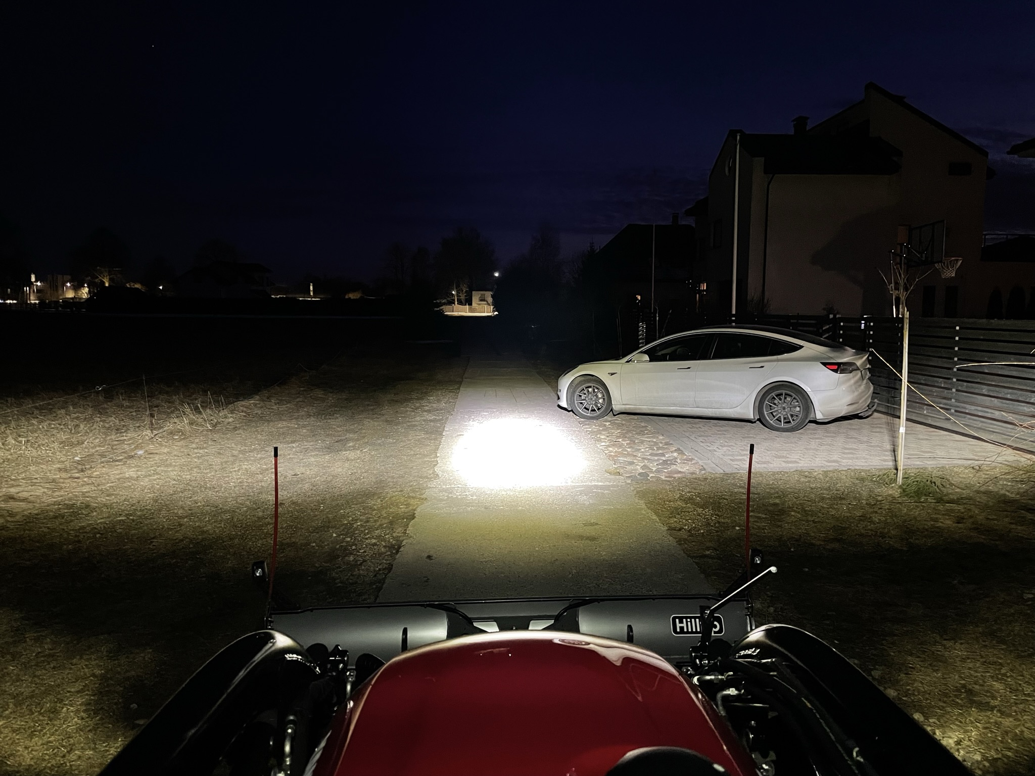

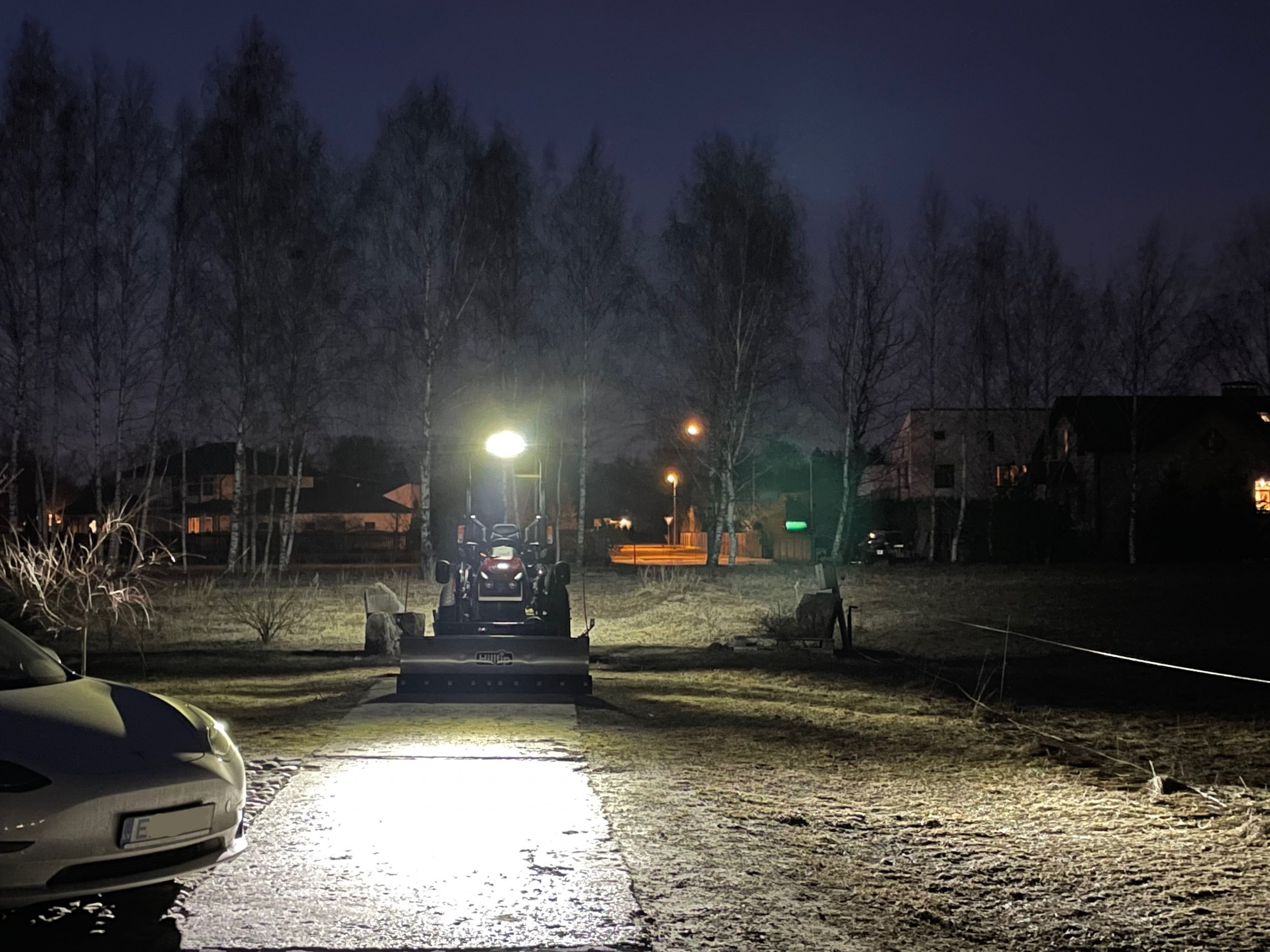

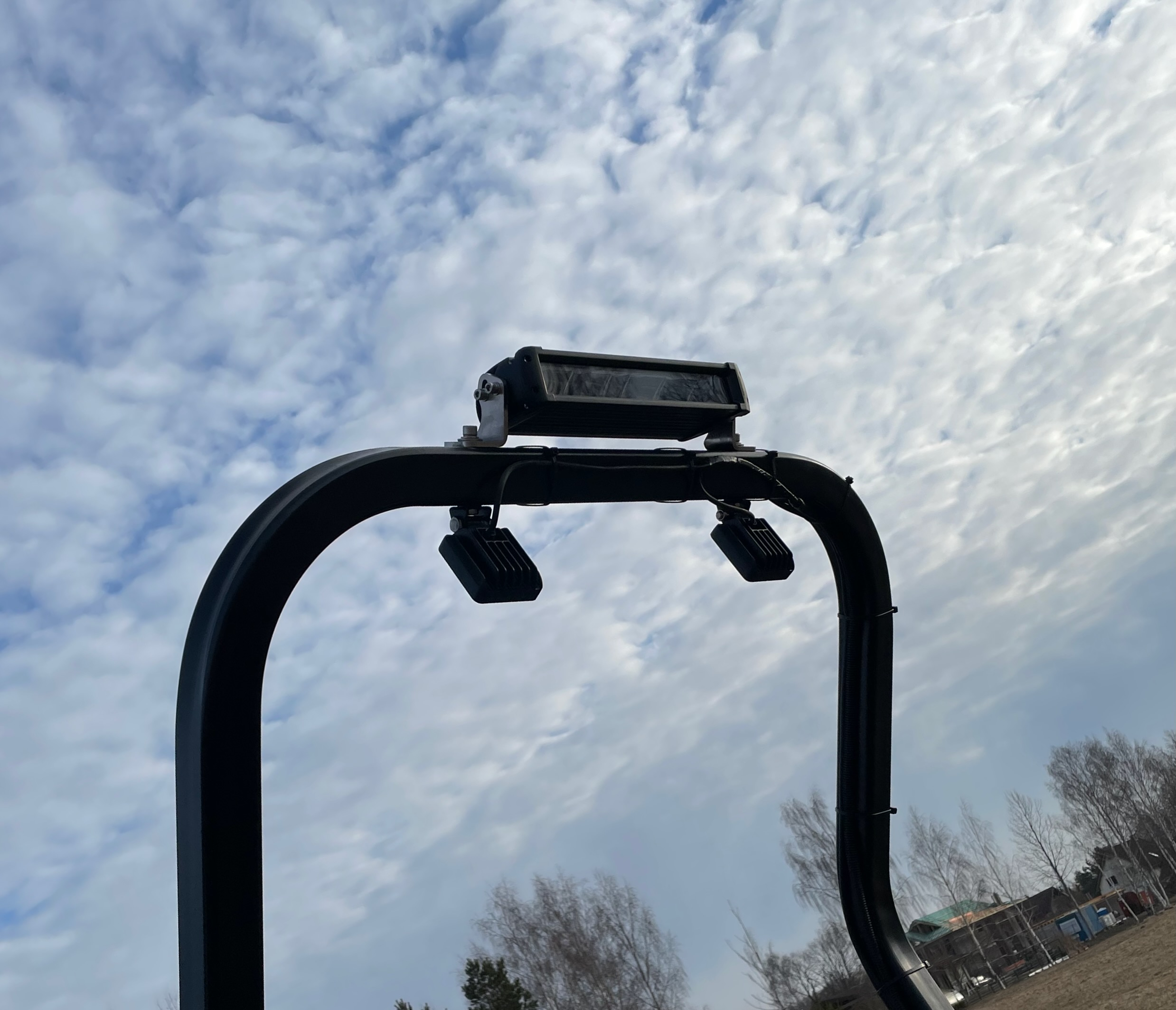

I have recently gone trough that
At the end bought this osram
1. it's "combo" beam
2. 30 W = 2... 3 A
3. 1 Lx = 360 m
4. not so big, really tough body. on my ROPS already was holes, this ledbar fit there without drilling anything
