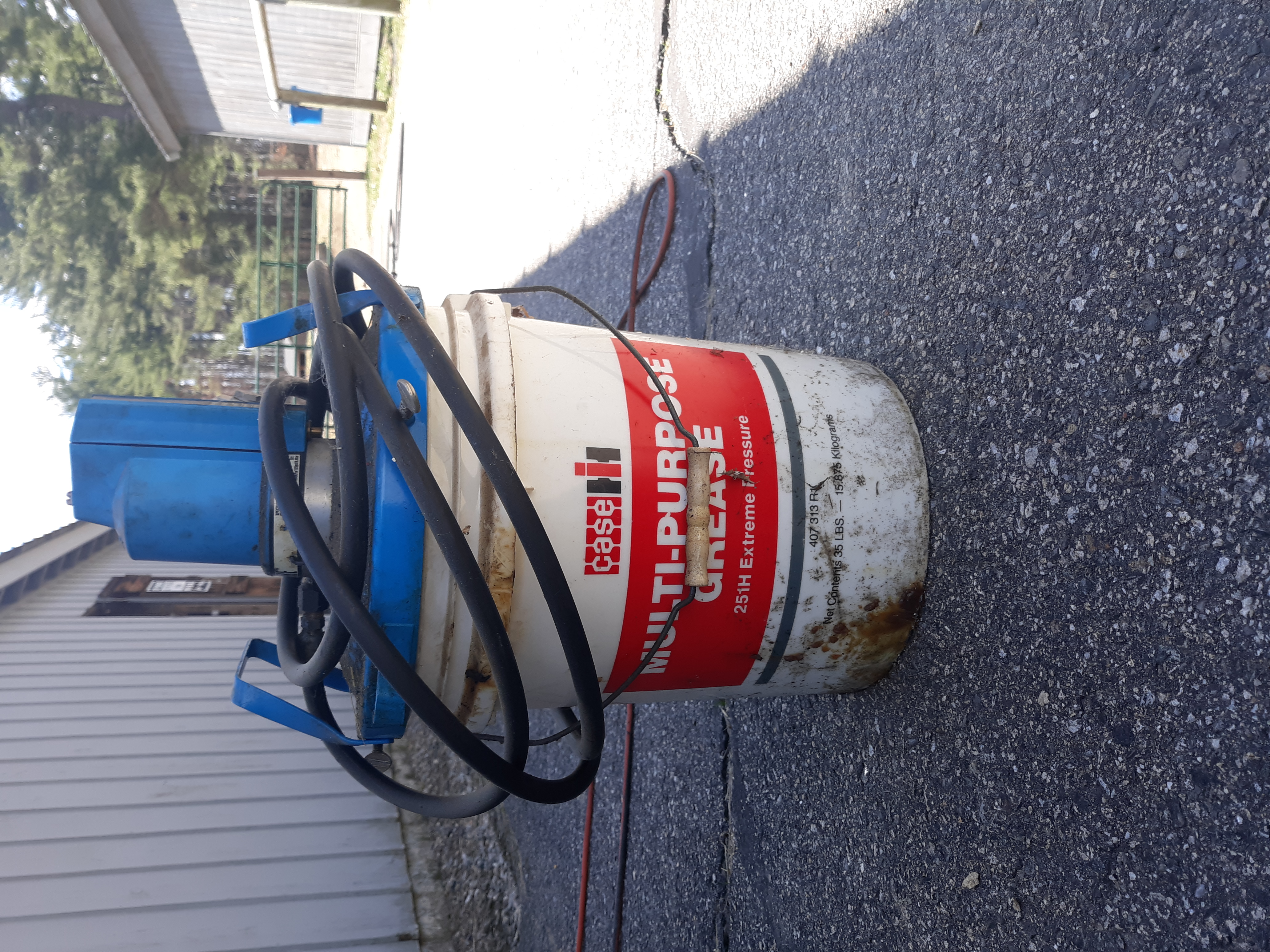

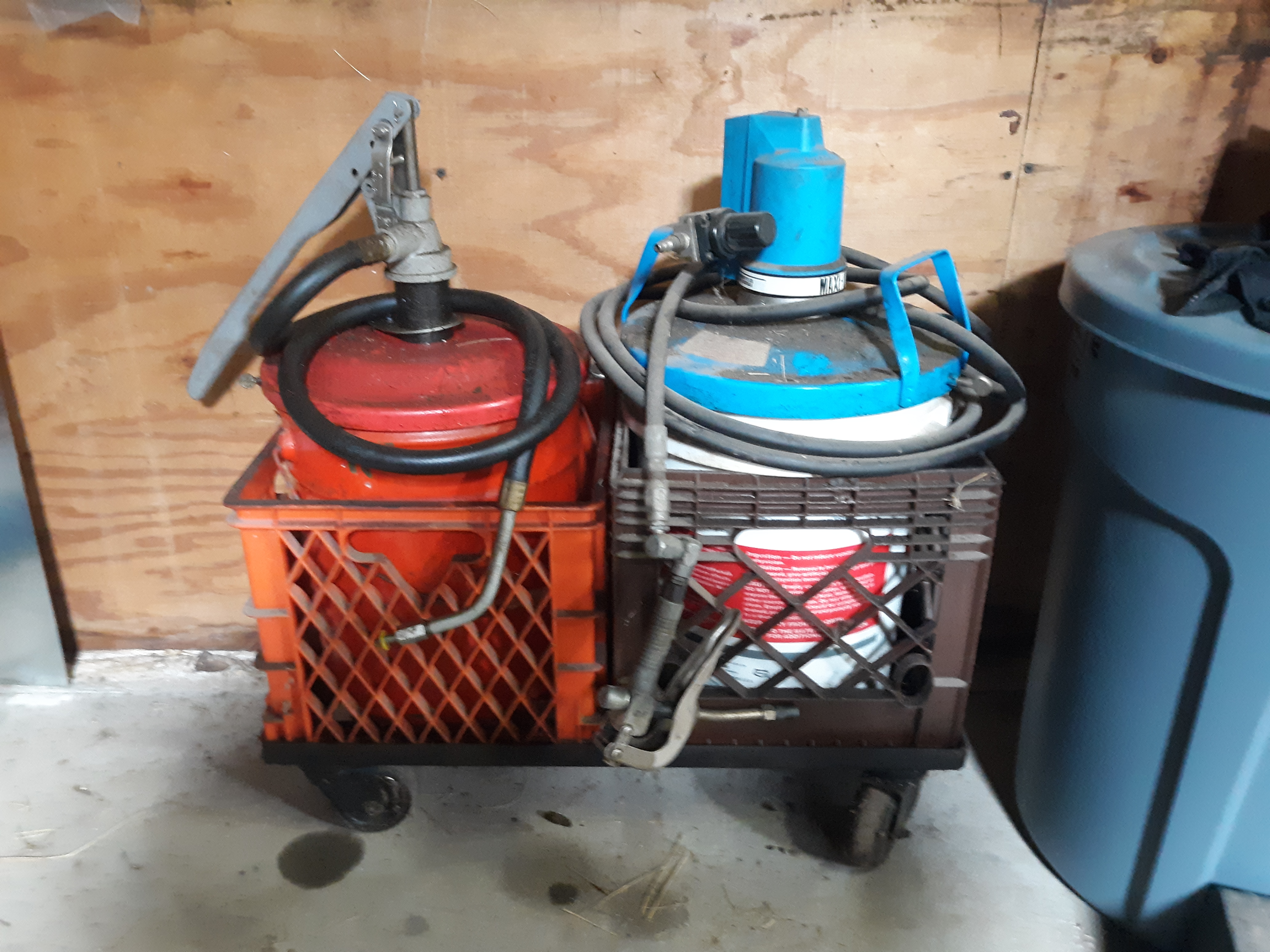

My tractor stickers and manual says to grease every 10 hours. I grease my machines every fill up which is approximately 10-12 hours. Easier to keep track that way. I buy grease in 5 gallon pails and use an air greaser. Cartridges suck IMHO, messy and wasteful.
You cant over grease - it just gets wasted and ends up on the ground. You can UNDER grease which will be detrimental to the life expectancy of your machine. 50 hour grease intervals does not sound reasonable.
Pins and bushings for the most part cannot be overgreased. Ball and roller bearings with seals surely can.
